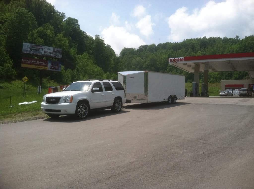

I tow 7500lbs all day with mine, big rims, small turbo, pulls great, i have a 24ft v nose. i have a 3.73 gear and im going to a 4.10 i think, just want a little more gear. the yukon pulls it great, very stable, i wouldnt pull anything with a reg cab truck, the wheel base is too small

Yukon has the same wheelbase as an rcsb...
is it really? i guess the extra weight makes it more stable, i have pulled my enclosed around with a reg cab empty and it feels way different.
Maybe true, but the Yukon is alot heavier, and has better weight distribution than the RCSB.

I was just commenting on his wheelbase comment, but its been my experience that wheelbase affects towing much more than weight within reason. There isn't but about 800# difference between an rcsb and a Yukon which isn't much considering the gcvw of that rig is going to be pushing 10k. The LD hitch changes the game. Short wheelbase vehicles suffer from "porpoising" when using a weight carrying hitch due to the front of the vehicle having less leverage over the hitch due to the short wheelbase. But since he will be using a LD which equals the load between the axles, LD hitched totally change the way a trailer pulls and will make the load tolerable. Longer wheelbase and more weight on the tow vehicle will always help for sure. Load range E tires really help make a ton of difference.
