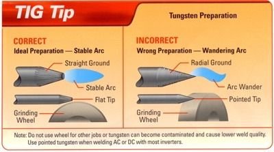

Got this off google- but when I was in class for tig this was a big help to do's and do not's
