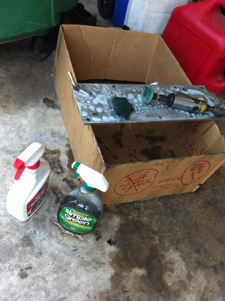

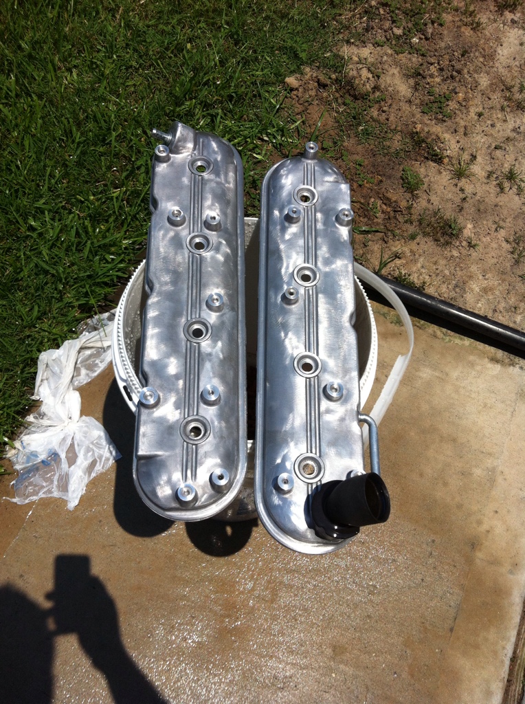

i use green and it makes the job EASY. so much better than a razor blade...here is how a green did on my covers over the weekend. wish i had a before pic. they were stained up. especially the valley cover.
i really dont see a reason to go any stronger. green will knock off anything that we need to no problem.
