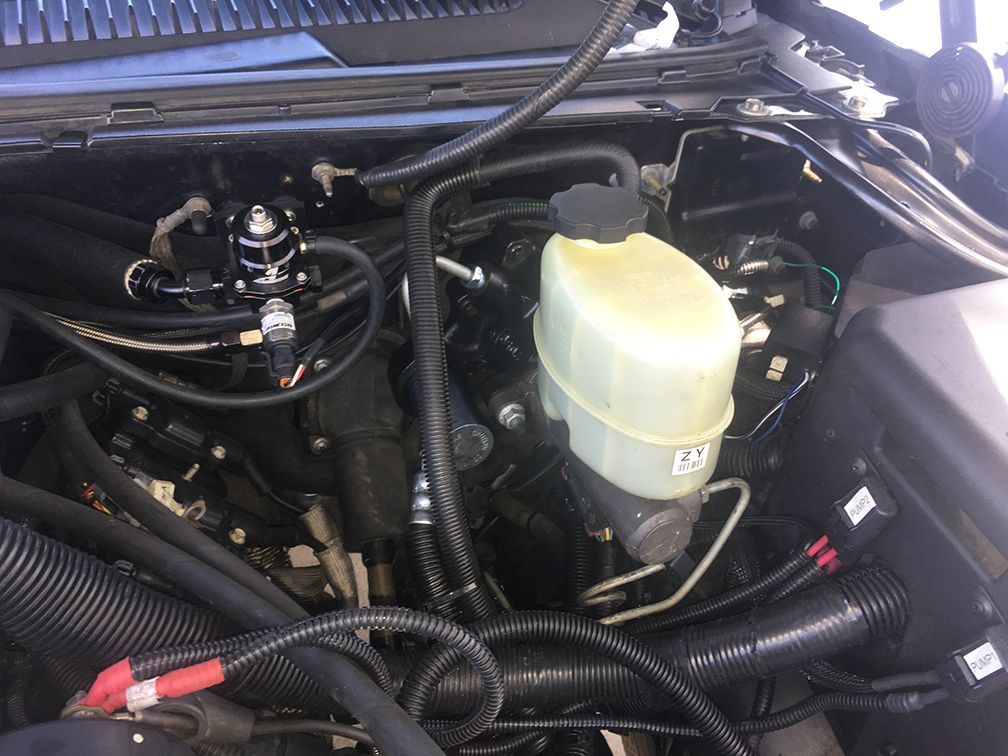

I'm not exactly the first to do it, but I think there's some confusion regarding exactly what is needed and what isn't. In my opinion, the hydroboost pump should be considered a necessity. Here's my finished unit, I'm stoked on it!
https://cimg5.ibsrv.net/gimg/www.per...e5373fa7e9.jpg
https://cimg6.ibsrv.net/gimg/www.per...a9848ca038.jpg
