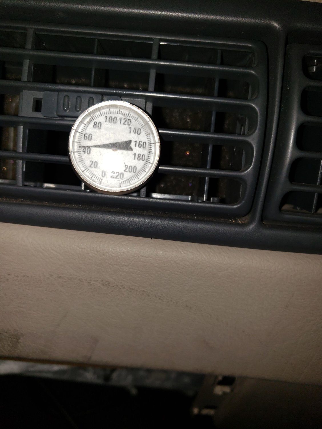

Vent temps in 102°F from the left vent after idling for ~10 minutes with the puller fan running, both blowers on high and using recirculate. Center vent was 38°F.

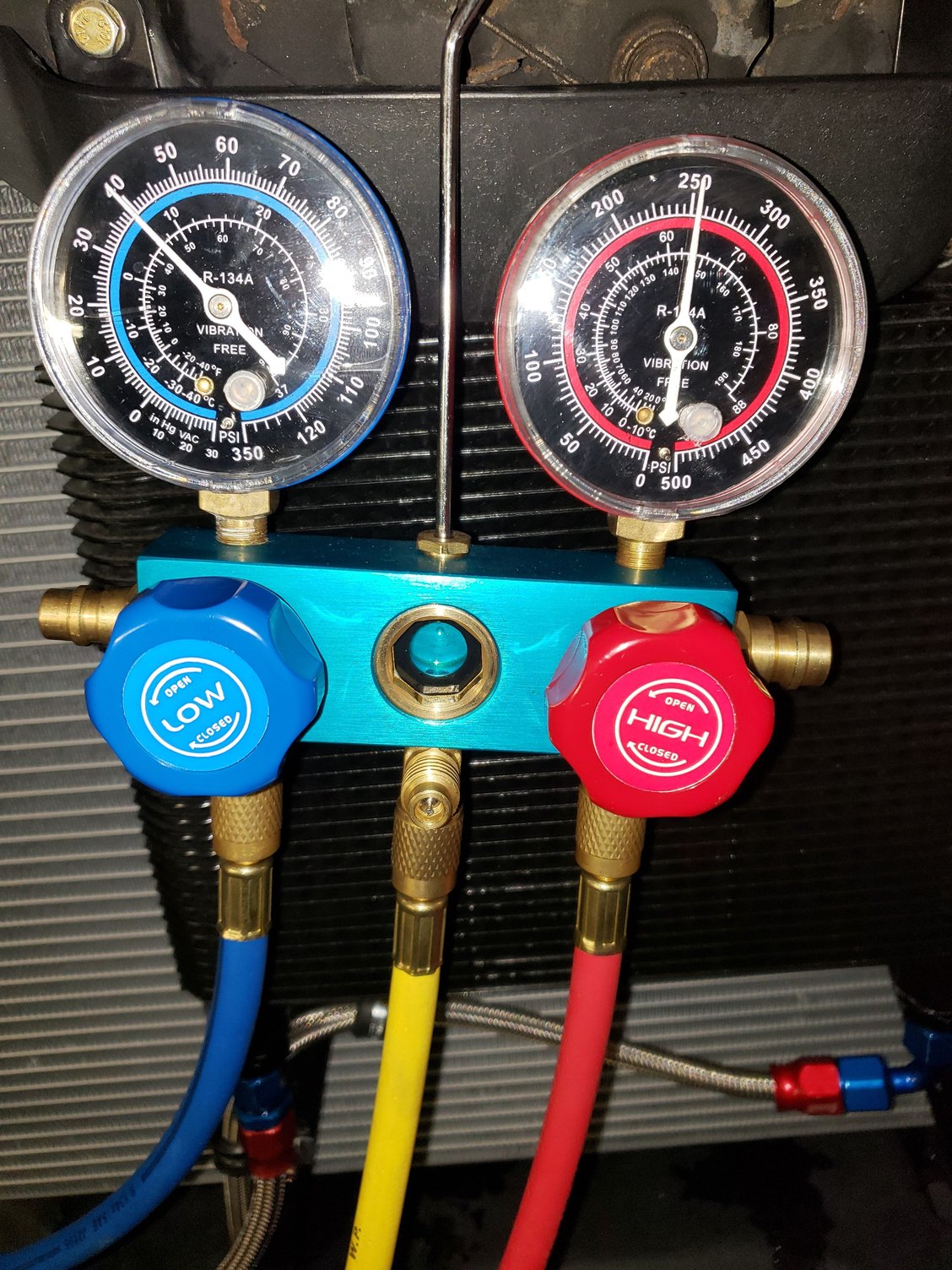

AC Pressures with the puller fan running.

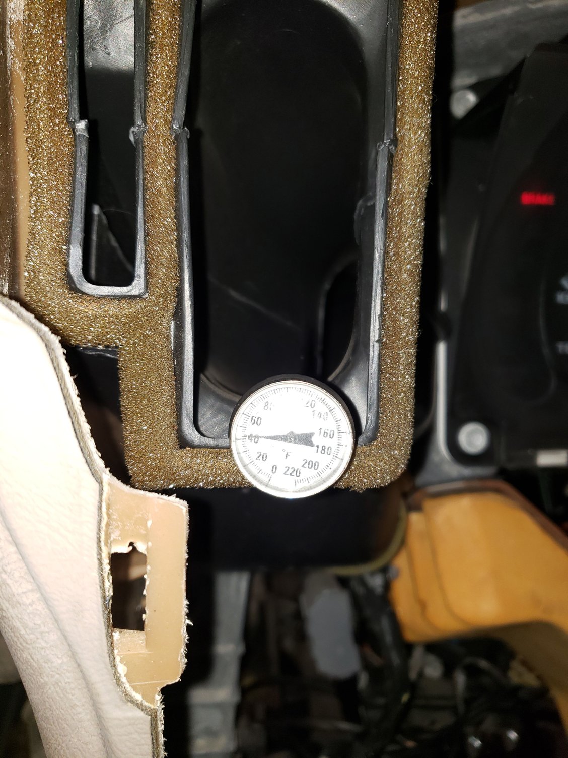

Center vent after 10 minutes with the puller switched off.

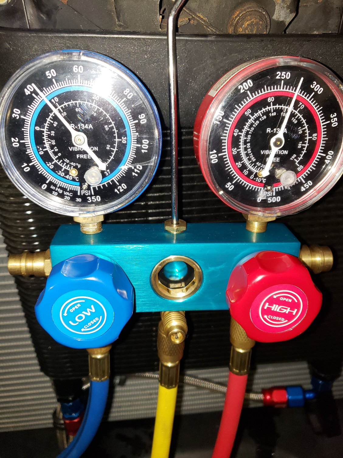

AC pressures after 10 minutes with the puller off.
I also stress the point on the refrigerant difference. At 39 psi R134a is boiling at 44°F, vent temps would be about 49°F. At 43 psi R134a is boiling at 48°F and vent temps would be about 53°F. At 39 psi R152a is boiling at 33°F resulting in the 38°F vent temps. At 43 PSI the R152a is boiling about 38°F resulting in the 43°F vent temps. The low side pressures on my system are about the same with R134a or R152a. R152a runs at substantially less high side pressure than R134a.
