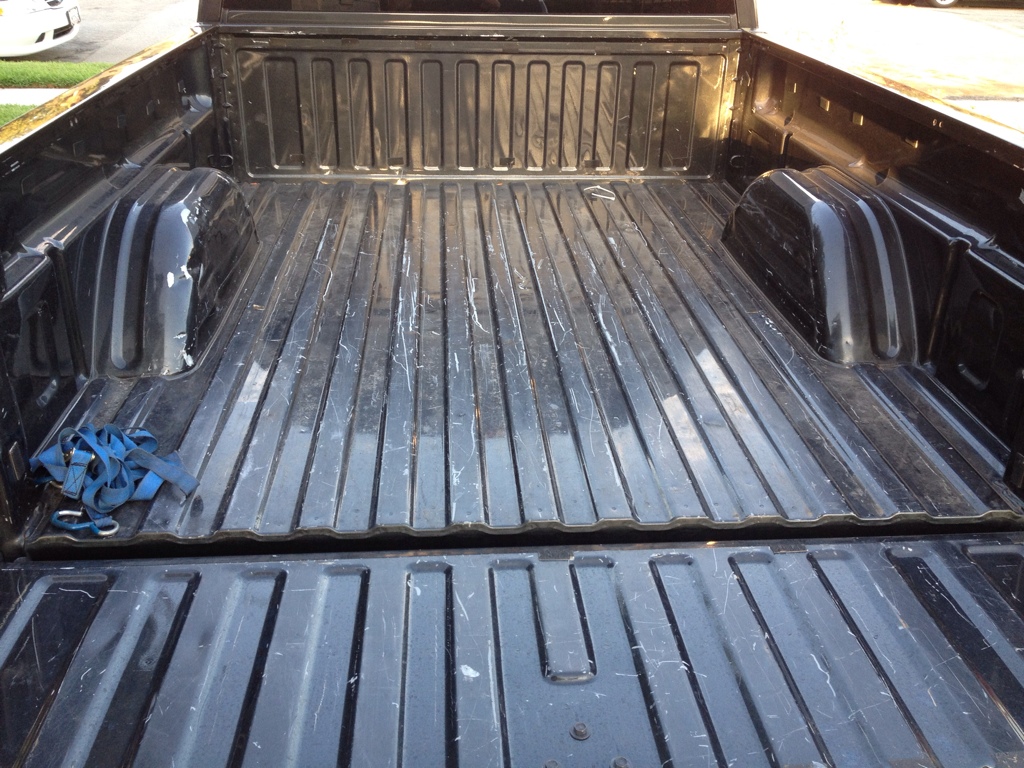

So I decided to finally do something about my dented and scratched up truck bed.
Attachment 129146
Attachment 129147
After seeing the results from a few roll-on kits, I knew that wasn't for me. so after looking around I came across this kit from SEM Products and pulled the trigger on it.

Prepping consisted of 80 grit discs on the electric sander and 100 grid paper my hand to get in all of the ribs and crevices of the bed. Then the body hammers and a little bit of bondo to fix the dents. The bed liner will cover most dents by it's self, but I am super picky and just wanted to make sure it was as close to perfect underneath before spraying it on.
