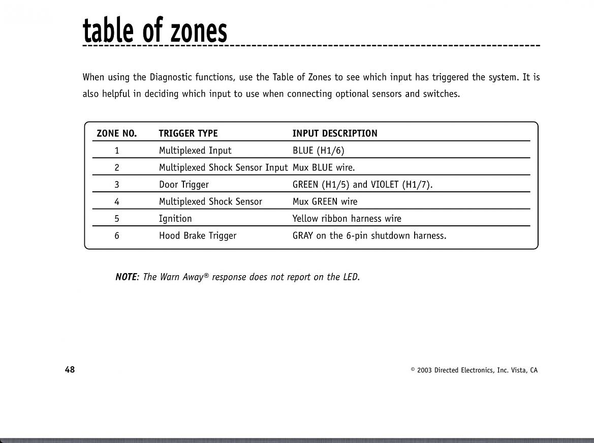

A week ago my security light came on a few times, it has since been off and no traces of it (no codes). Now my alarm randomly goes off for 45 seconds at a time (Hornet alarm system). I accidentally cut the wire going to the Siren over a month ago when my drill bit hit it but soldered and shrink wrapped it. The alarm LED light is indicating Zone 1, MULTIPLEXED Input is being triggered. Any help/brainstorming is appreciated.
Thanks
