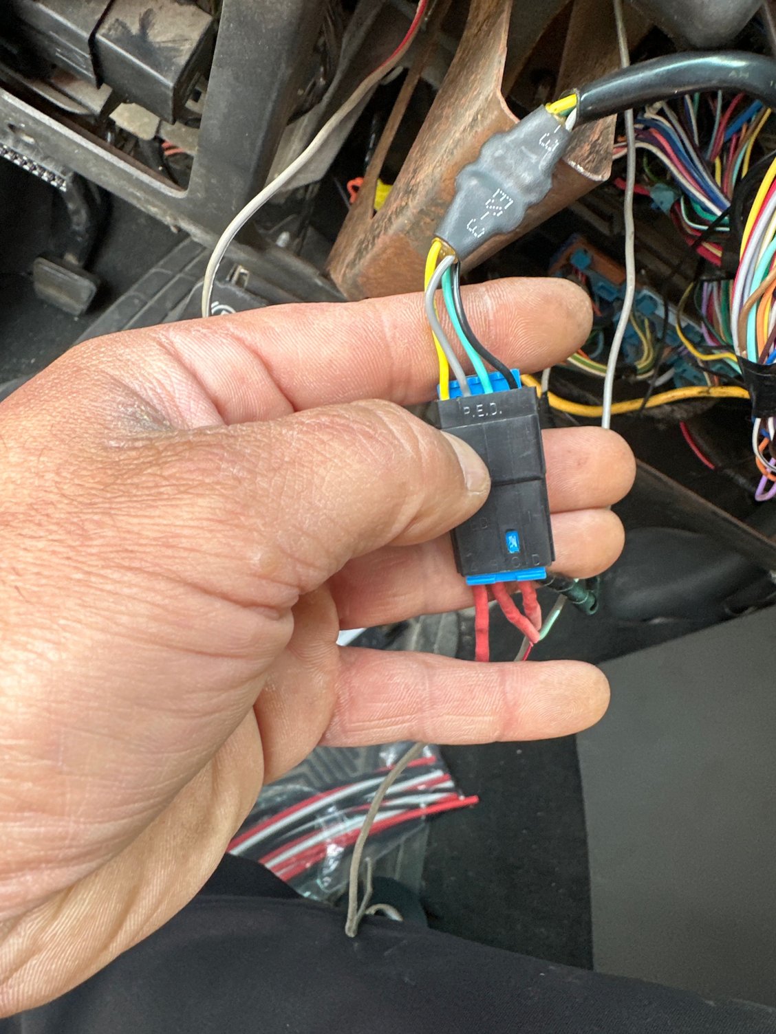

Hello there! I’ve been searching EVERYWHERE for which wires do what in a 2002 Escalade steering wheel control harness, I cannot find anything definitive, and I’m desperate! Could you PLEASE tell me which wire is which? I’m doing a custom swap of an 02 Escalade wheel (and clock spring) into a 2000 Silverado. I have a maestro SW and I will enter custom values for OHMs. One place I’ve found says green is remote, another says yellow. I’ve tried both setups and I’m worried I’ve fried the controls, as when I check resistance it is fluctuating at times. I’m at a full stop I don’t want to ruin this wheel please help?

Green is data.
I made a video about this swap for my truck, skip to 17:20 on video

He answers in the video, but yellow is generally 12v battery voltage, and looks to be thicker than the rest.
