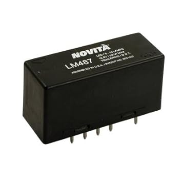

That will cure the hyperflash ^^^ ... but also FYI you can hack the factory flasher; I've done it on the older cube style flashers from previous generation trucks and they use the same timer IC in them as this newer double unit. I just have to get a good look at the circuit board to see which pin to cut on the IC.
A warning as I just re-read and saw you are planning on using switchbacks. My experience so far has not been good. My truck is generating right at 15V when running, which freaks the switchbacks out and makes the running light function start to flicker wildly. With the engine off, they are perfectly happy at 12V battery power. After some reading it seems common and normal that the newer trucks are just like this. My next step is to try some simple voltage regulators inline with them to see if that helps. For now I just have regular non-switchback LED's up there.
Seriously though the LM487 flasher is the trick; all the exterior bulbs in my '06 are LED. Signals (which I doubled up, eliminating the DRL's), corners, and tail/brake.
