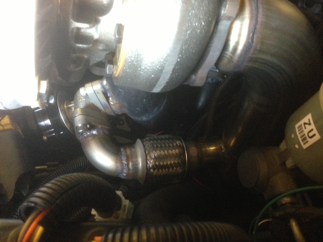

Yes. They are installed.
First shows how tight things are around those wires. They could go between the dp and gate vent pipe. But great care must be taken in this area.
Wrapping pipes, shielding master cylinder area and shield wires. Are a must.
I personally would reroute the wires around and out of the way.

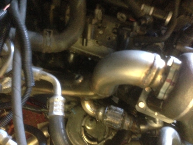

Huge amounts of room on this side.

Anyone think that the gas cylinder on a hydroboost system would hit the driver side down pipe? These gas cylinders do vary in size, so some may or may not have issues. It does like tight.
