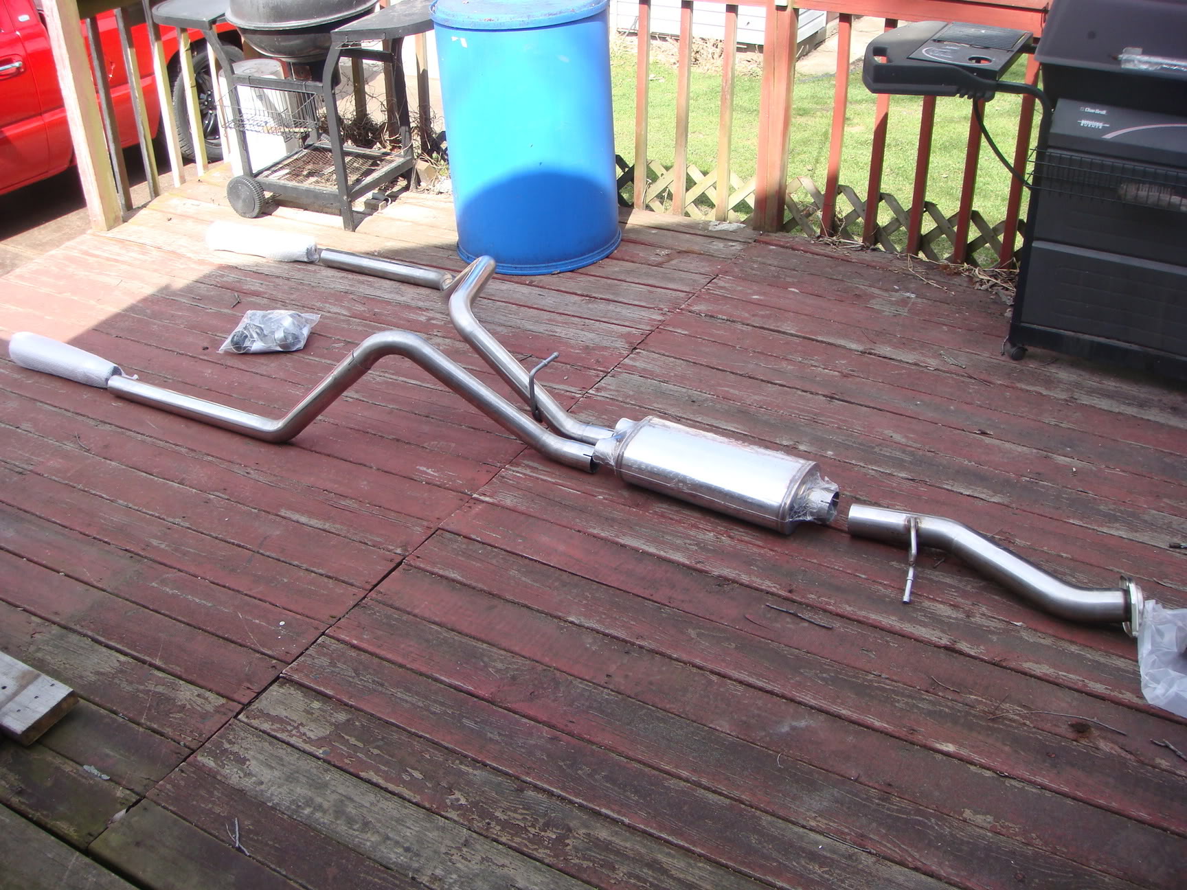

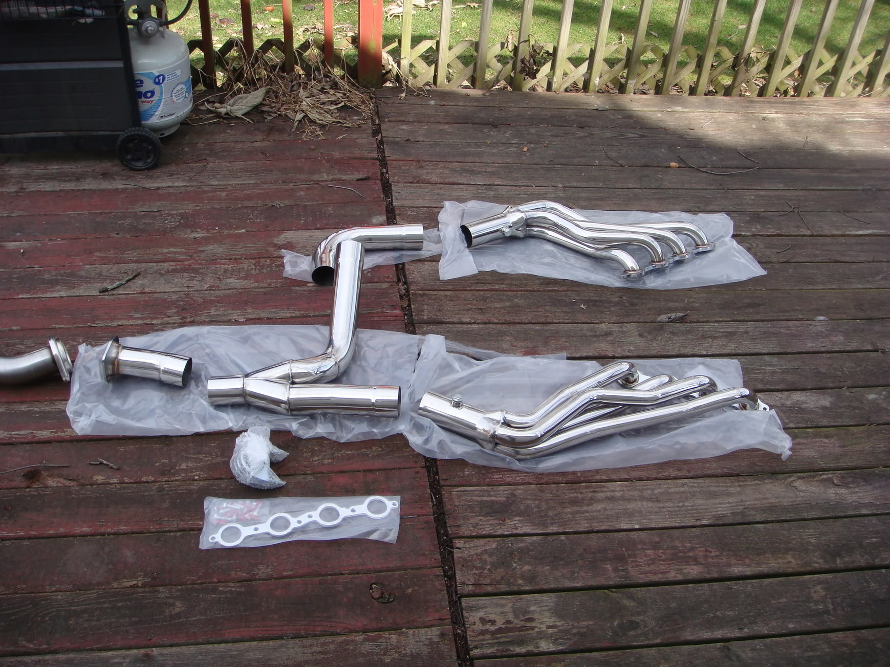

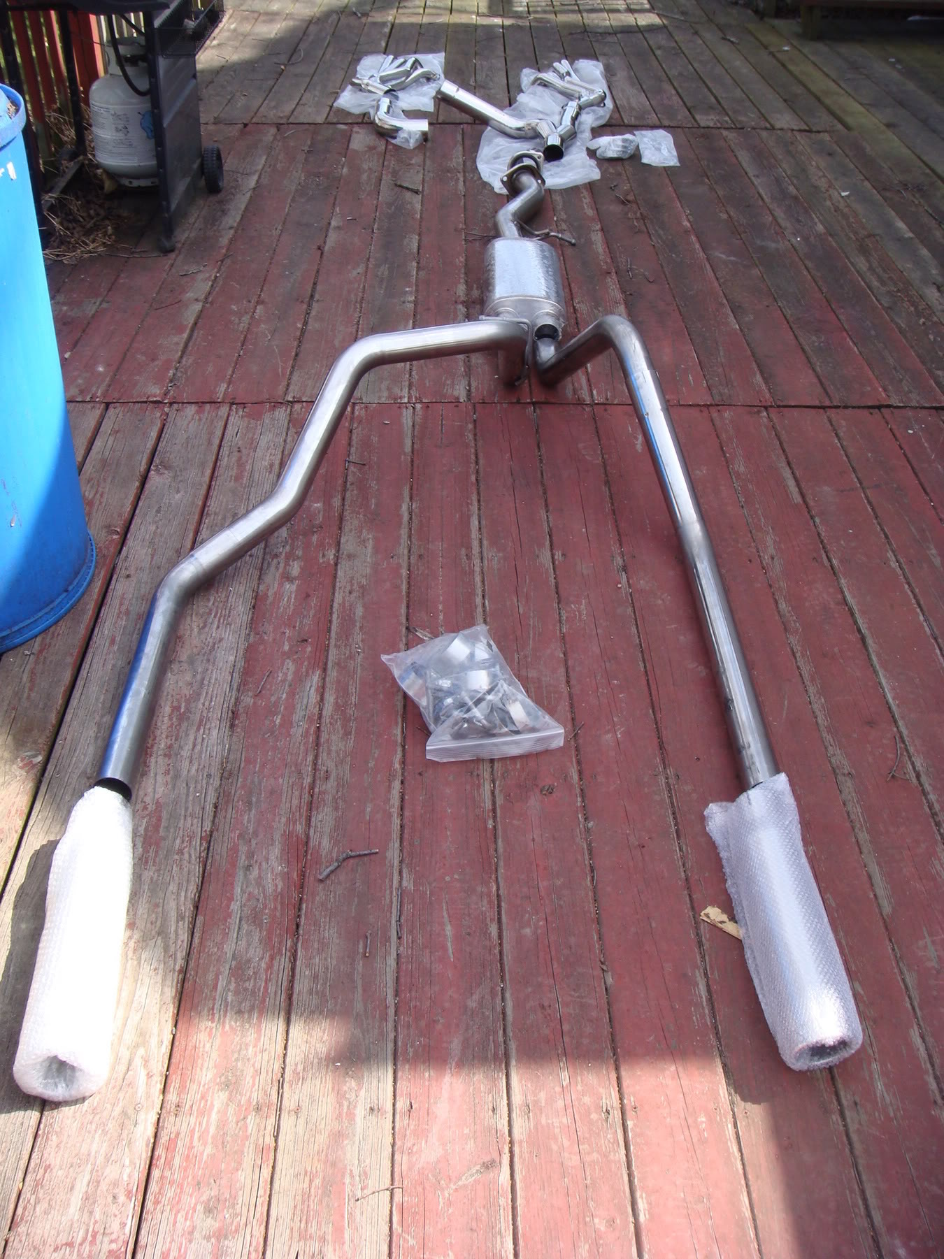

well i got half of the new exhuast up yesterday. if i would have rushed i probably could have gotten it all done, but i didnt want to eff anything up or make it look half-assed. i hopefully will be getting into the tip modification tonight and getting that little write-up i was talking about tomorrow or sunday. i do know that i am going to have to section the tail pipes on the magnaflow exhaust to get them up behind the rollpan and then figure out what i have to do for piping into the tips.
ill post some pics alittle later today.
by the way the lpp headers and y look great, and fit nicely. the only issue i see with them at the moment is the cheap $.99 exhaust clamps they come with. i stripped one out trying to put it on. ill be getting different ones today and as soon as i can afford it im going to get some stainless band type calmps. the mangaflow catback looks really good too we will see how the bends and everything setup later.
if you guys have any questions let me know and ill try to get pics and answers for you.

here are the first few pics i have taken. sorry bout the size didnt have time to resize.

^^^^that is a an awesome looking exhaust, looking forward to hearing it!

I know I have asked this before, but I never got a direct answer, and now that you put up pics and talked about your exhaust I'll ask again.
Why do you guys run a Y-pipe setup instead of an X or H pipe setup with true duals?
Old Mar 20, 2010 | 06:03 AM
  #1418
RED04REGENCYRST's Avatar
Joined: Feb 2006
Posts: 983
From: monee, il
i had attempted to build my own exhuast and did true duals with an x-pipe in the muffler. it was nice, but lay on your back trying to mock up and weld doesnt work to well and so it wasnt of the quailty i wanted, so it came down and this is going in. way down the road it might get done that way and be done to my standard.
but to better answer your question is probably due to the fact that the y-pipe doesnt hurt the performance to any serious degree, so why change it? and the y is just easier plumbing under the truck, i know. lol.
