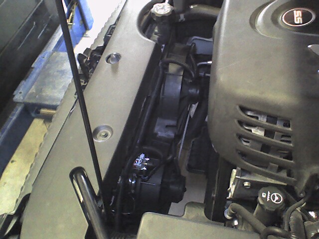

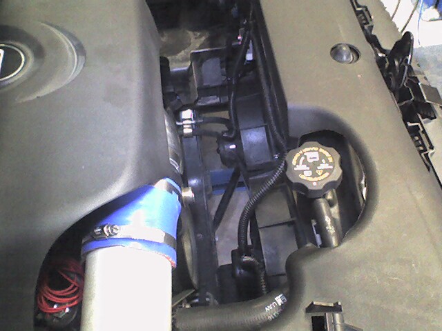

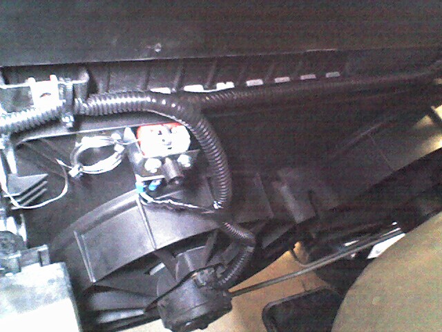

Just finished putting the finishing touches on mine. Pretty simple really- I just used a Flex-a-Lite adjustable fan controller for one side (p/n 31147), and a 4- prong 30 amp relay and tapped the dark green wire on the a/c compressor for the other fan control.
The first pic is the controller (I know its kinda Mickey Mouse lookin, but it works). I have the controller just wired striaght to hot so the fans will stay running after I shut the car off (but turn off at whatever temp I desire [from 160*-220*]). I did this so it'll cool down quicker in the pits at the track.
Its a great (and cheap) way to put in electric fans without having to buy the pre-fabbed one from Nelson or whoever and have your ECM reprogrammed.
If anyone wants some help on doing it, just PM me..
Attached Thumbnails Electric fans???-controller.jpg   Electric fans???-fans.jpg   Electric fans???-fans2.jpg

I forgot to mention, after you do this, its super simple to install a home-made intake (like my shitty lookin one), without worrying about the fan hitting it..
