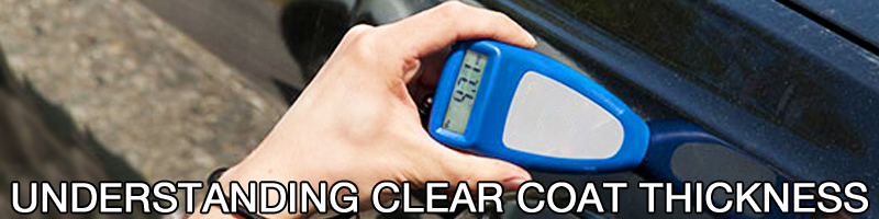

You can verify this or get a more precise measurement for your exact car by using a paint thickness gauge. They can be found for as little as $150 online, but be aware that lower cost meters will only register thickness readings on steel panels - so aluminum, plastic, carbon fiber, fiber glass, and similar surfaces won't be able to be read. Meters that can read these other (non-ferrous) materials tend to be much more expensive.

NOTE: Anyone looking for a decent paint gauge thats relatively inexpensive I have been using this model, purchased on Amazon for about $150 and for the price has been very good.
Just realize that this meter in particular only measures total coating thickness, and does not differentiate between base and clear, but it at least gives you something to gauge the reduction of the surface.
