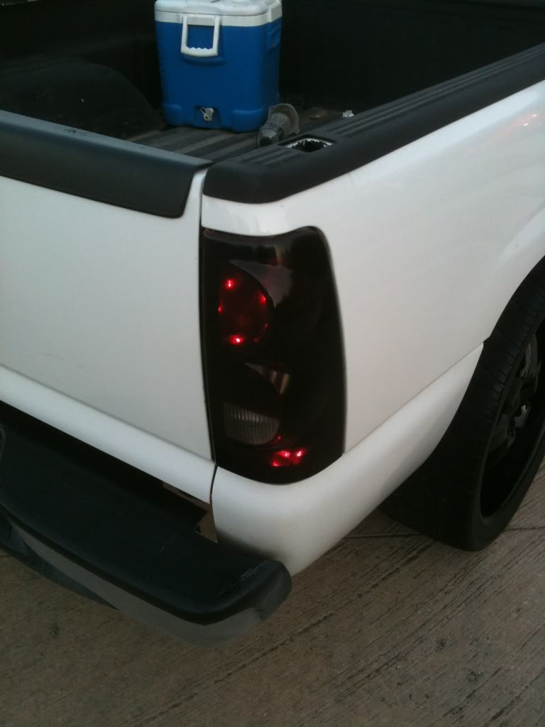

The 194 is just a "secondary" blinker light. 03-04 are the same it's 05 when they added the extra bulb. Don't know if you can see the extra light at the bottom or not but they're from an 05.Name:  2C5DA801-A287-4EA0-AC66-0FDBD088BB09-3861-000003FD33D9DC3F.jpg

Gotcha. Sounds like an extra light that is basically unneeded so I probably wouldn't even bother putting one in. IMHO, the little light at the bottom looks out of place anyways.
