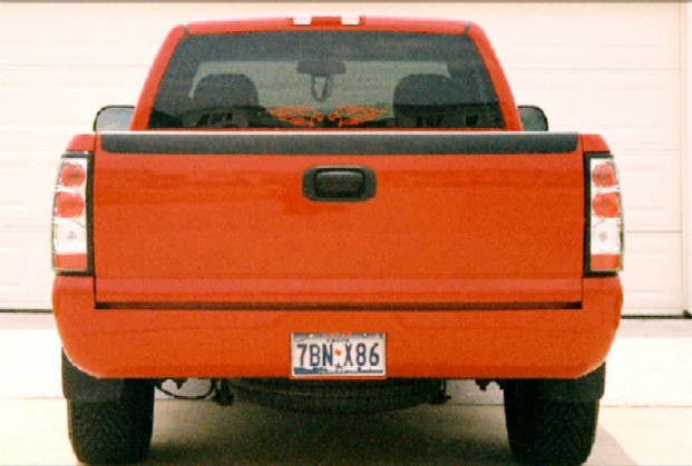

sir micheals roll pans will work with the factory tire. there is a square cut out behind the license plate. you will have to invest in a spare tire relocator that moves the tire mount forward about 3" and you will have to remove the plastic tube. other than that it is pretty straight forward and it doesn't look bad. I carry a flat blade screwdriver to remove the plate in case of a flat. as mentioned you can buy a flip down plate also. Install of the relocator takes about 5 minutes.
see picture with offensive spare hanging behind my pan
