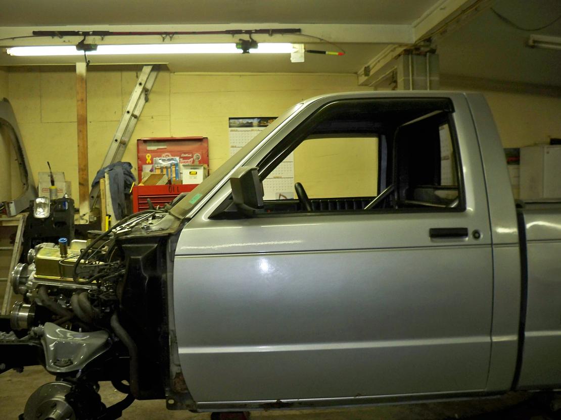

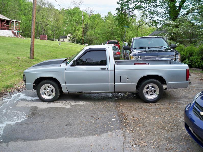

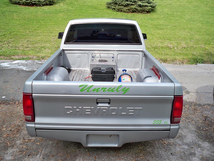

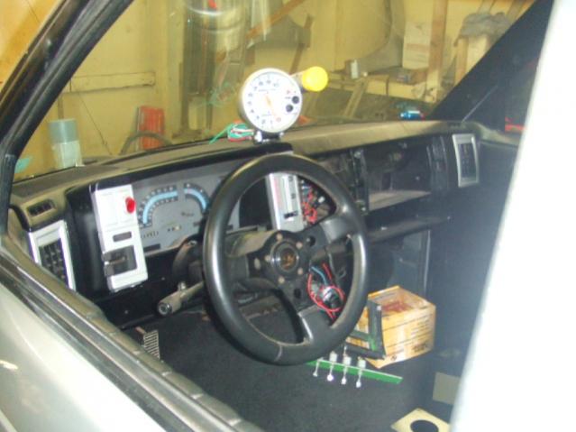

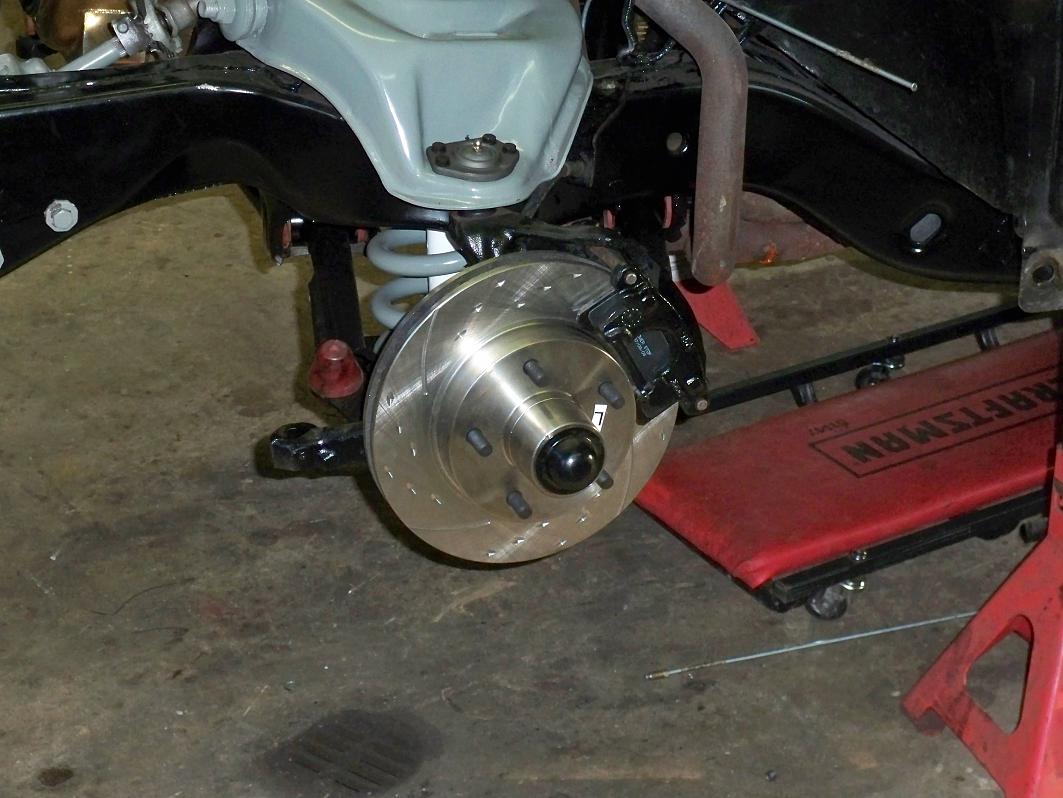

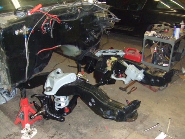

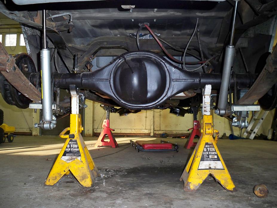

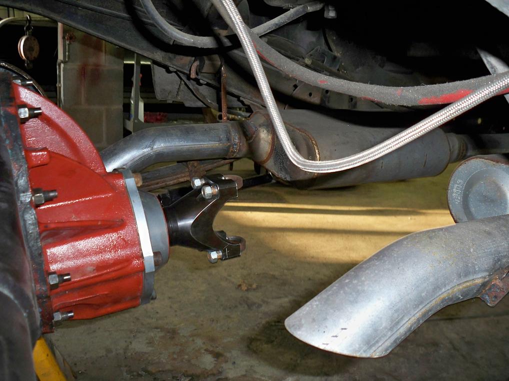

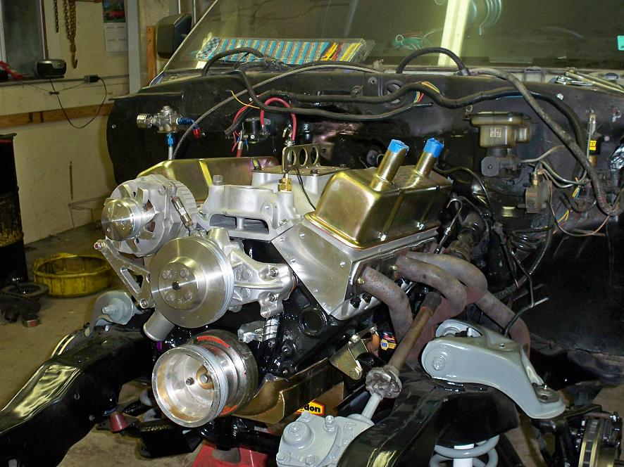

Well boght this last year rolling and started tearing it further apart .Fabbed a new front member striped the frame built an engine ex ex . tell me what you thank so far lol Truck is a 91 s10 .355 bes racing engine forged crank,h beam rods,probe forged pistons ,dart alm , full roller cam up ,th 350 trans ford 9 inch moser housing and axles strange center section 456 gears 200 shot plate system . getting ready to send it out to get the body work done and get on some paint

some pics

a few more

Thanks cant wait to get it on the road motor dyno numbers were a lil over 450 without the coke and all together cut out about 350 pounds gona be a blast on 9 inch radials
