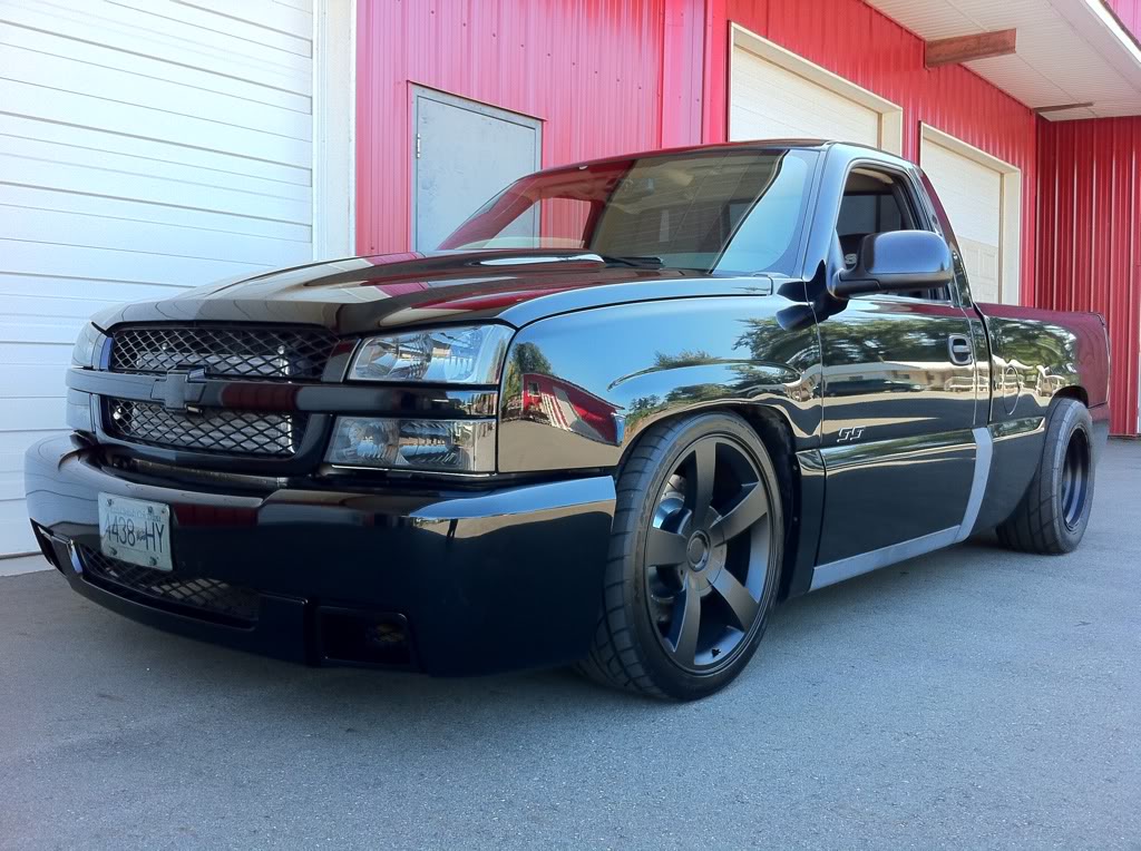

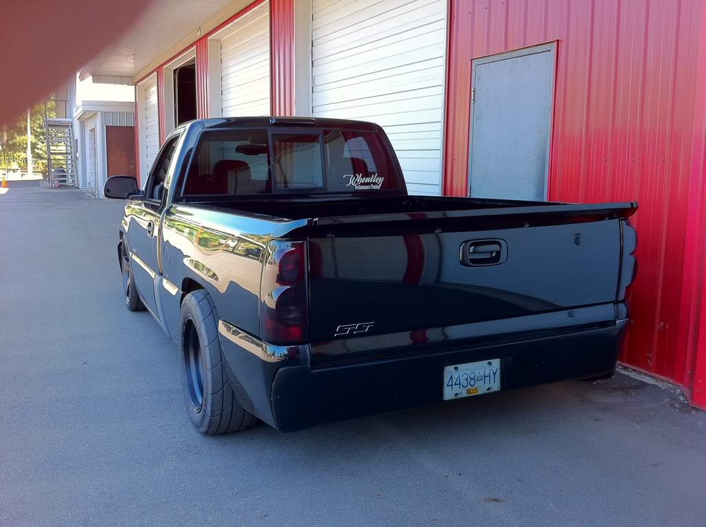

i got the rear of the truck jacked up now, put the stock hangers back on and added another overload spring.

Originally Posted by brandon6.0
hey man love the look of the truck. Looks like its hauling *** just sittin lol. If u dont mind me askin whats the drop on your truck. I plan on going with ss wheels and i want it to set about where u are. Love the look.
Front is 2" drop spindle with 3" drop coil but i have a 1/2" spacer on it so the fron is 4 1/2" drop.
Rear is 2" drop hanger, 2" drop shackle and 2" drop leaf spring with the over load removed so that makes the rear 6 1/2" drop.
Also had to add a bolt in c-notch, all my parts used are belltech.
If i was to do it again i would just do a flip kit in the rear, but i only wanted 4" drop in the rear before i went lower and lower....

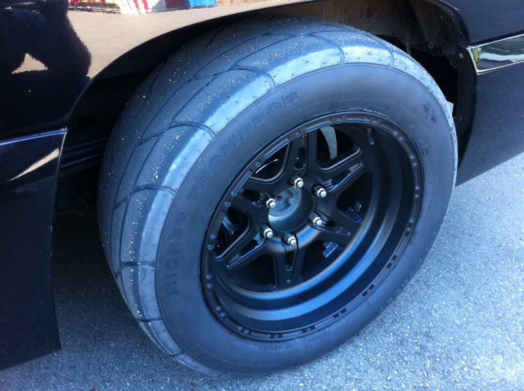

Originally Posted by Silverado_SS_04
i got them used for only $200 for 4
to get a rim that would tuck it would need a 45+ offset and in not paying 1k+ for those......
....... trying to save money to finish the cladding ...
Roger, I'm still waiting for your rolling burnout vid w/o standing on the brakes.
Ya, like John, I too wondered why u couldn't have gotten correct b/s, but for $200 I see why. Nice score on some sweet wheels.
I figured u had the cladding finished, weren't u workin on that quite a while back?
Top 2 pics make it look purpose built, for race. Just waitin its turn to run. Nice stance, nice truck.
