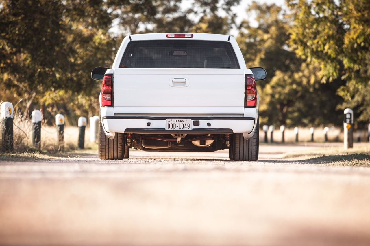

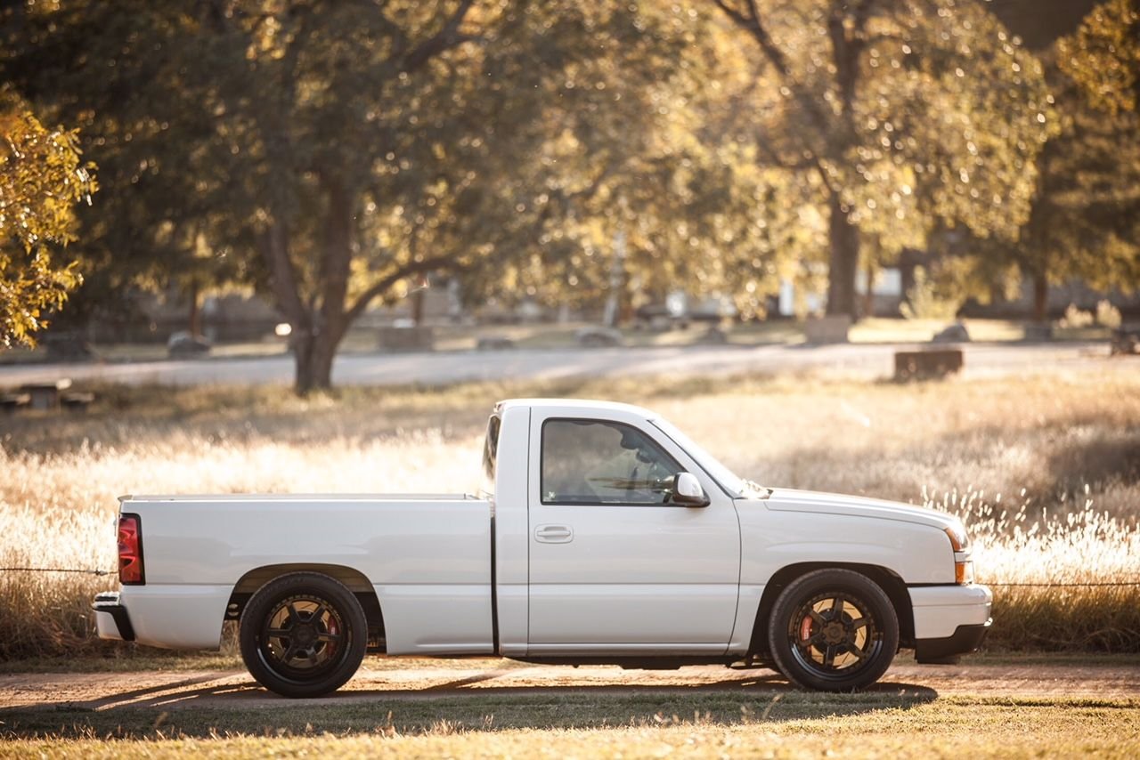

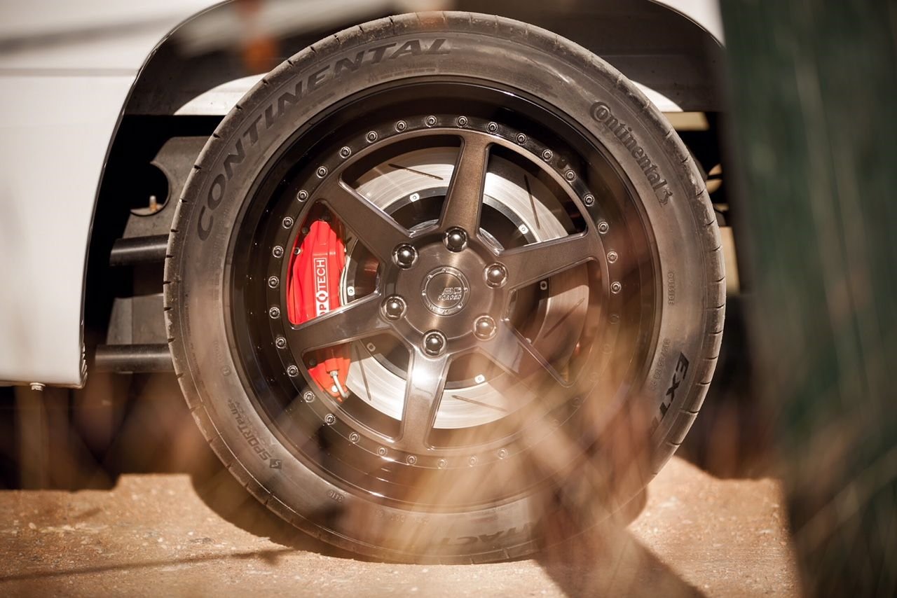

After searching endlessly to find the perfect set of wheels, I came across BC Forged. They had just come out with a new 6 lug design and didn't have many pictures of them yet as they were brand new, but they looked pretty sweet so I decided to give them a shot.
I honestly couldn't be happier with the result. They have the best customer service I've ever experienced. Dan at BC forged and I went back and forth making sure every detail was nailed down.
I ended up with the LE-61 in 20x9.5 and 20x11 with 275/40 and 315/35 Contental Extreme Contact Sport tires. Here are a few pictures of the finished product. Enjoy!

Thanks! I am running a tbss rear axle so the rear offset is slightly different. They are 20x9.5” +20 for the front and 20x11” +3 for the rear. This gave me about 1/4” from the outside of the lip to the edge of the fender. I had to roll the fenders to make it all work but it looks perfect.
