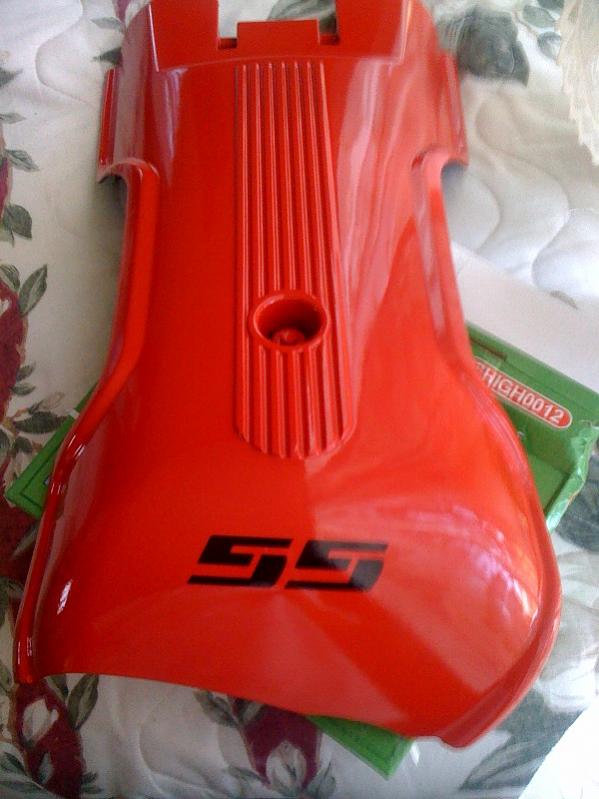

40,80,180,320,600
primer
paint
clear
Attached Thumbnails Need some ideas for 3 Piece Engine Cover-photo-18-.jpg   Need some ideas for 3 Piece Engine Cover-photo-46-.jpg   Need some ideas for 3 Piece Engine Cover-photo-45-.jpg

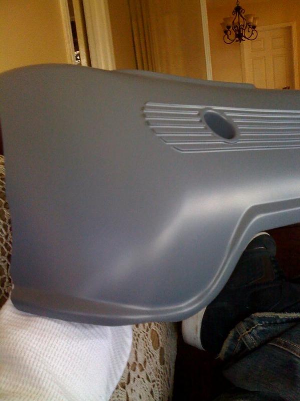

i dont have the 3 piece cover, but here is mine.

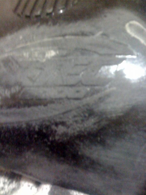

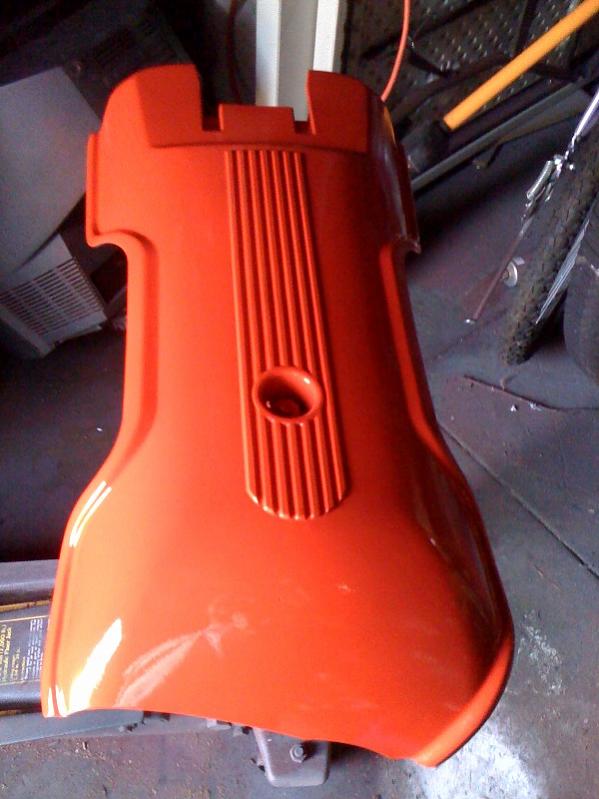

I tried the cut off wheel at first also and it jus left alot of deep scracthes. I used jb weld to cover most of them up and it did the trick. I missed a small scratch though
