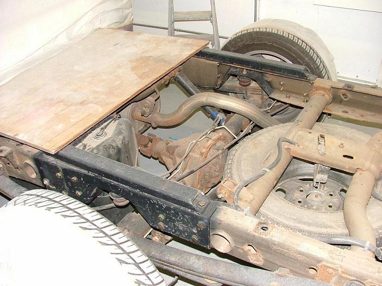

Yea, It's a bolt on. Very nice notch - It wraps the frame and has a 1 1/2" X 2" 1/4" wall tube along the top (not one of them cheezy flat plate deals) I spent a few hours on it but not really bustin my *** either. They are around $215.00 new but I got mine on the forums for a little over a hundred.
With the air shocks I run 30 lbs. when I am unloaded and it does not lift the truck at all and I have plenty of room for the rear end to move. I don't regret the notch and would highly recommend it on a 4" - I know alot of guys run a 4" without it but it did not satisfy me. See attached pic.
LK
Attached Thumbnails need pics of trucks with 2"/4" drop-frame-notch.jpg

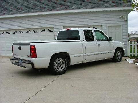

Hy guys I want to see pics of your truck with 2"/4" drop on stock tires and rims. Do these ride good, does it make the truck more stable around corners and such?
EDIT: How will a 2" front drop coil and a 4" rear drop shackle and drop spring hanger combination ride? Would it be better to get a lowering spindle or does it not rally matter?
Hey, I found one with the stockers!
LK
Attached Thumbnails need pics of trucks with 2"/4" drop-truck-2-4.jpg
