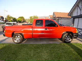

Here's what it looks like from the side...Much better!!!
Attached Thumbnails Daystar 2" leveling kit on '04, looks SICK!!!-trksideview.jpg

Why didn't you just lower the rear 2" to level it? Takes about 30 minutes with some drop shackles. I would only raise the truck if I were putting some offroad or larger diameter tires on it. Just my opinion.

I'll do that next time.*wink wink* Thanks for the opinion...
