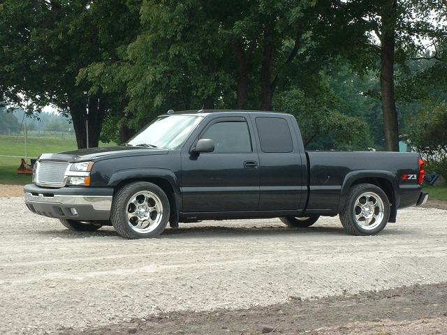

here is a pic of my truck, body cladding removed
I removed them due to a defect from the factory and the paint fading. It gives any truck a smooth, clean look. Don't forget to grab some adhesive remover, they're a pain to get off.
