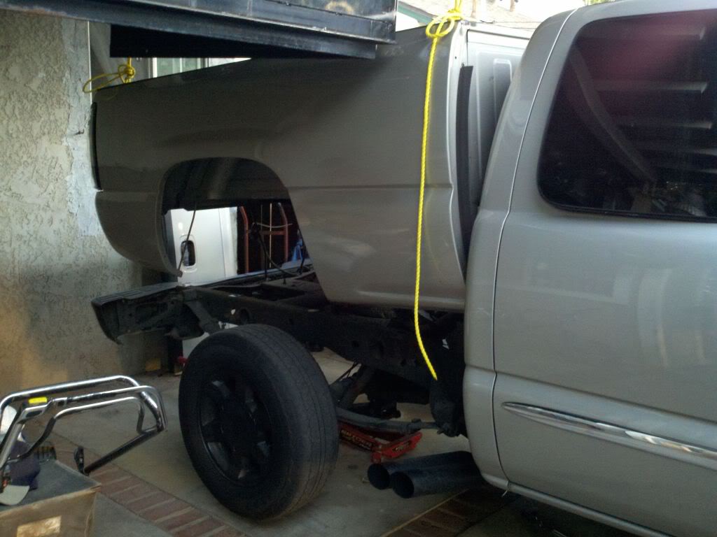

I'm working on truck its actually on stands rt now.. I'm in the progress of adding hangers so its just on drop keys decrancked removed blocks shakels and removed overloads.. truck rides good although I had to cut bumpstops upfront because they were hitting and ride was stiff.. but my truck is a z71 so it came stiffer from dealer so on use to it lol.. ill post pics when its done.. in the mean while here is a pic how I have it rt now and before I took it apart ..

2"drop keys removes blocks shakels and overload.. doing hangers out back to level it out as u can c it looks higher from the back
