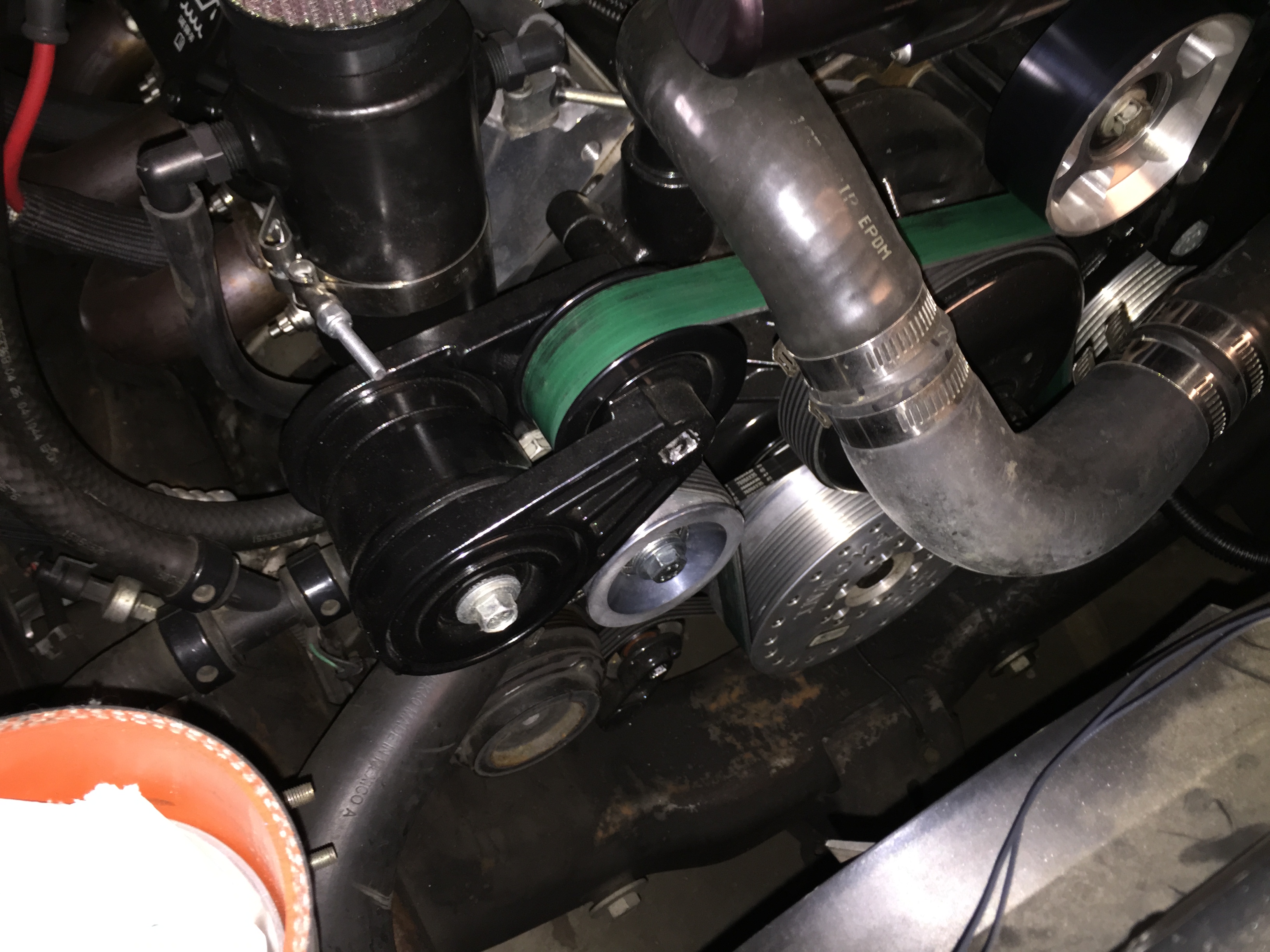

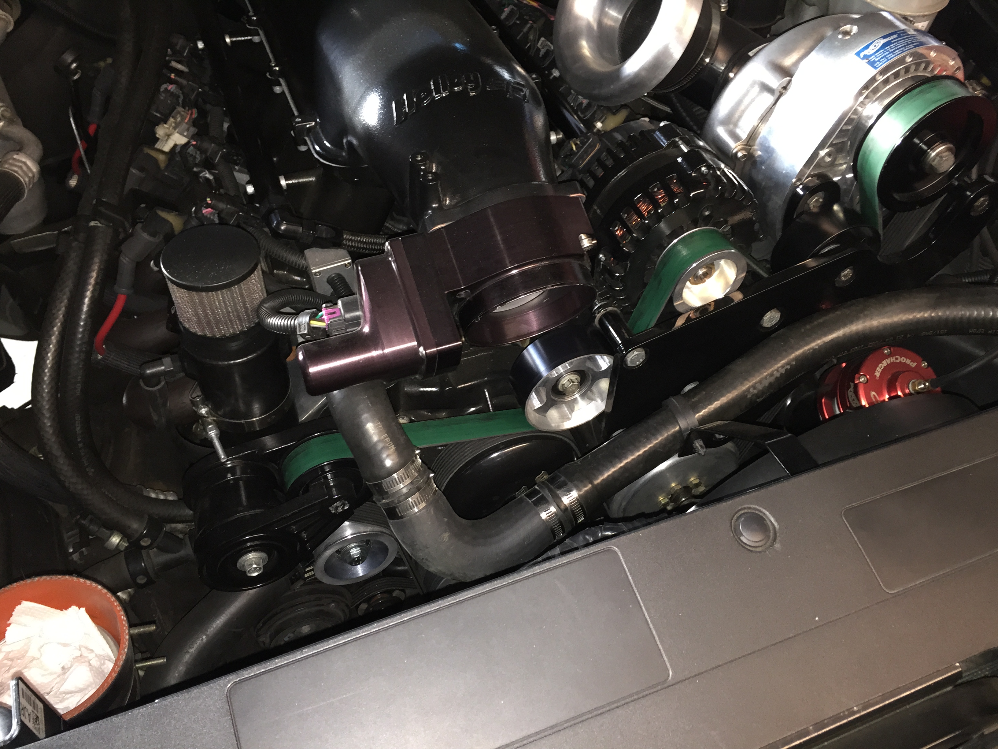

was having a problem with the belt rubbing on the inside of the HD tensioner, had to add a idler in between it and the crank pulley.

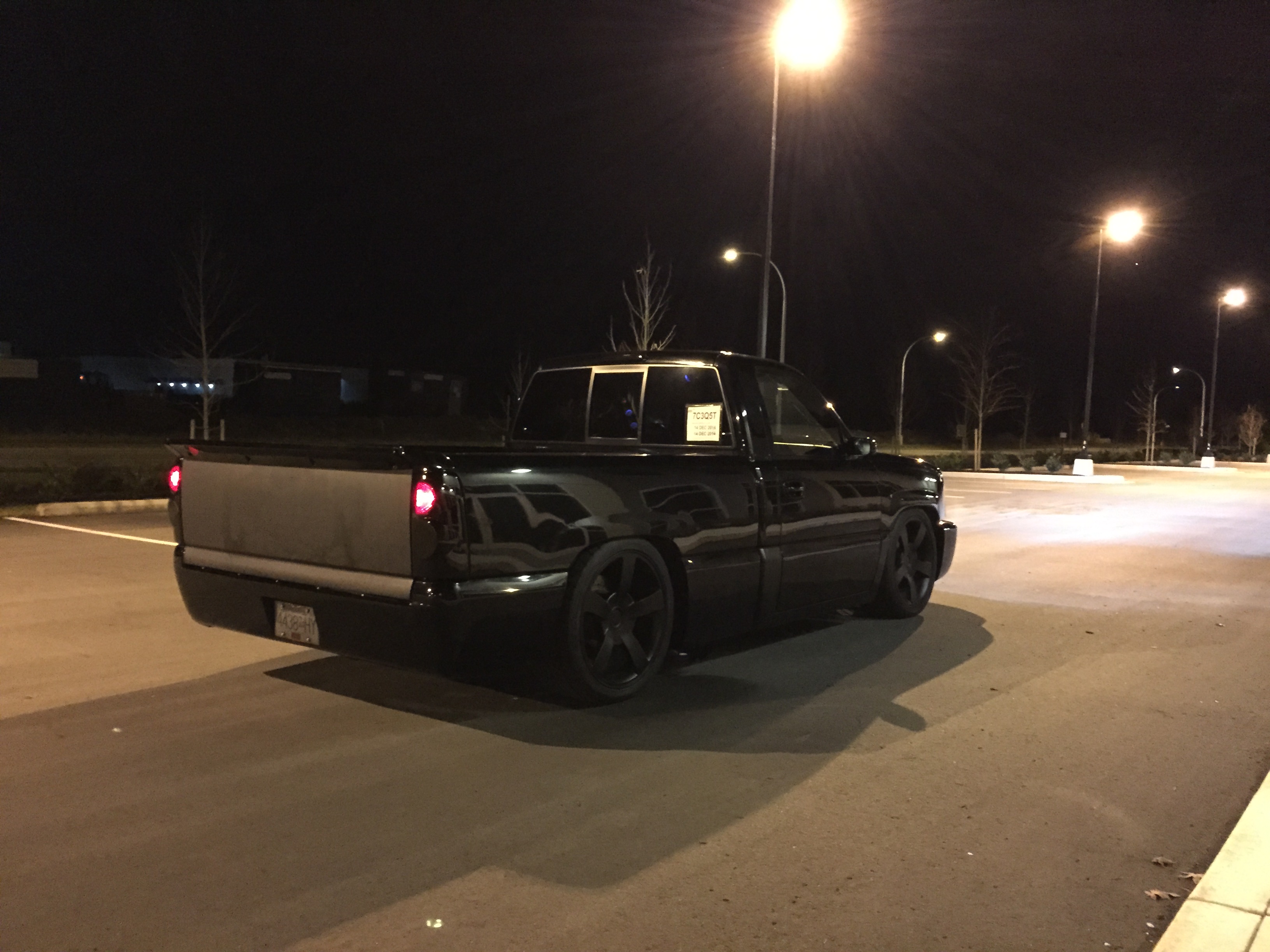

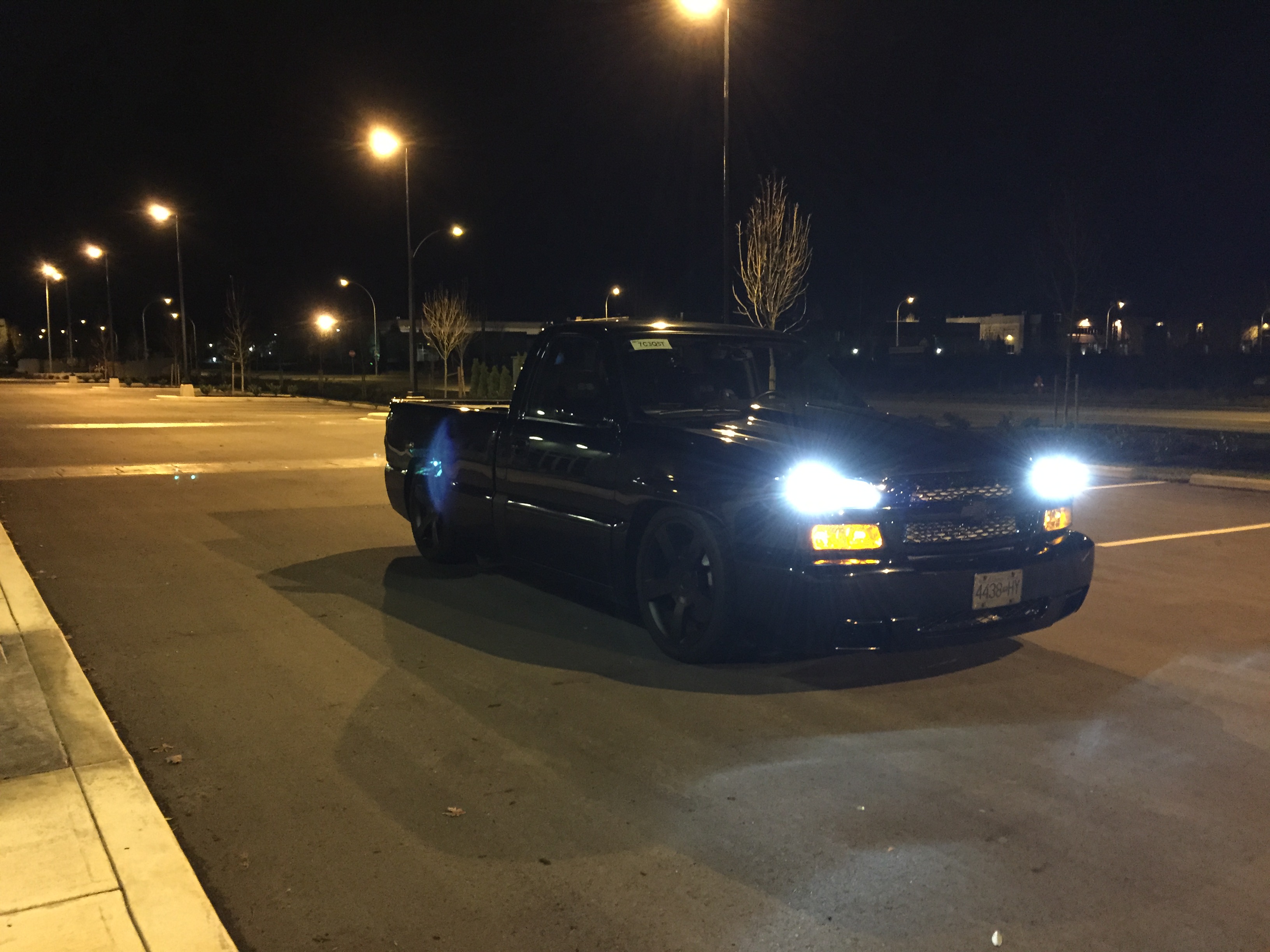

took the truck out today and everything seems to be good now.
light throttle third gear pull, yes i know my shitty ebay LEDs are burnt out : (

Nice fix with the extra idler. What length belt are you currently running? An alternative fix would be the next size shorter belt and reclock the tensioner to put it in optimal tension range.

i did the same setup with the extra idler and it solved my belt issues thank god
