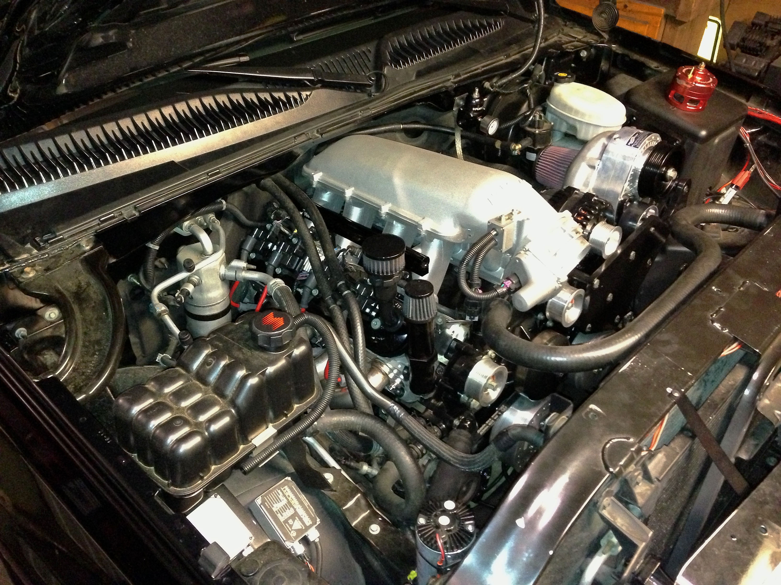

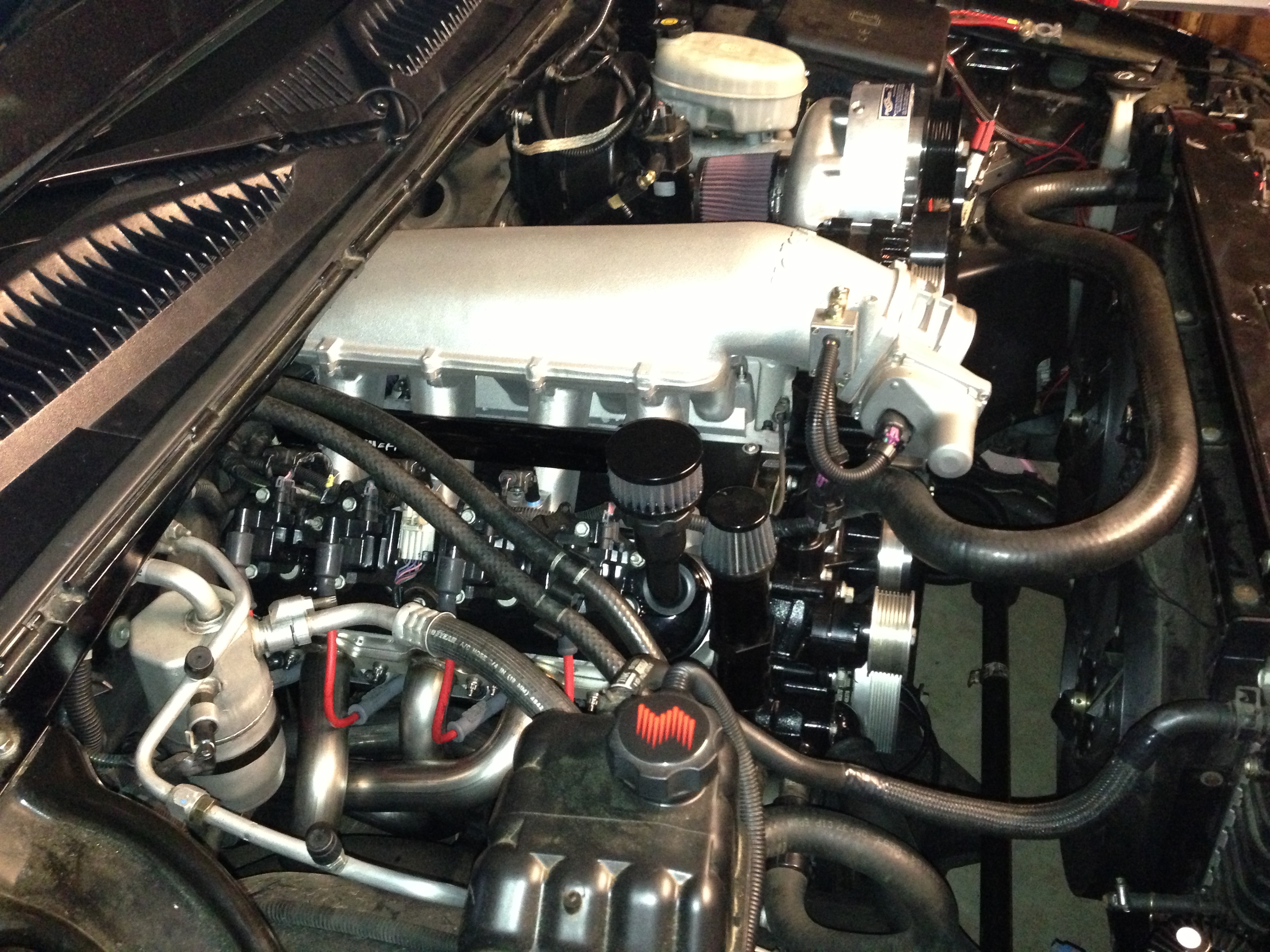

started working on the truck again, got the push rods in, valve covers on and coils on.

Air filter might be a restriction? Maybe not on a P1 but that beast.
If it is I can add a 45 off the head unit with a bigger filter.

Man, it might be the picture, but it looks like you pulley alignment could use a little work. Do you have a laser alignment tool?
Old Jan 24, 2013 | 11:26 PM
  #160
Boosted_Silverado's Avatar
Joined: Jan 2009
Posts: 689
From: Vancouver BC Canada
i have not spaced anything out yet, just bolted everything on for now.
once i measure and get my belt i will adjust everything to line up.
