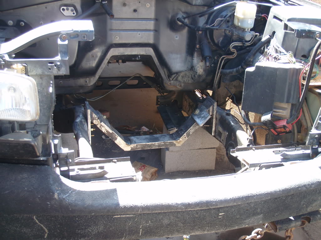

Yes i know big and square plate steel is not very sleek but i have no worries about strength on this sucker... Basically those rectangular 1/2" steel perches allows the cradle to scoot back 3" to a more flush area on the frame seeing how it curves on the passenger side, grade 8 bolted and lap welded.

Look no lifts! Name:  P1010005-2.jpg
Size:  90.6 KB Name:  P1010007.jpg
Size:  93.1 KB Jack holding up transmission not engineName:  P1010008-2.jpg

I should be working on the trans mounting but i'm putting that off for a few weeks to get this thing bolted up since the truck needs to be moved around the place.
By the way just in case anyone is thinking i like dirt and grease, i don't. Everything will be taken apart and stripped, cleaned and painted after all the custom work is finished, can't wait...Name:  P1010011.jpg
