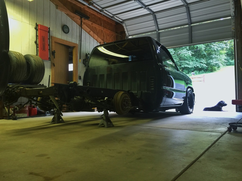

Bed is off and stock fuel system is removed. Think I'm going to have a fuel cell made locally, thought about going with a DbRods cell but he doesn't seem to come on this site much or have a website to contact him. Trans is currently apart and waiting on parts, were slowly but surely making progress

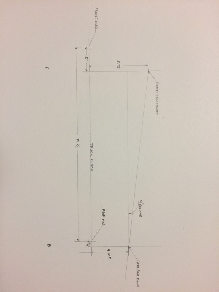

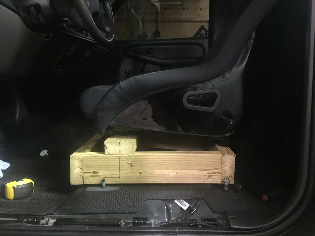

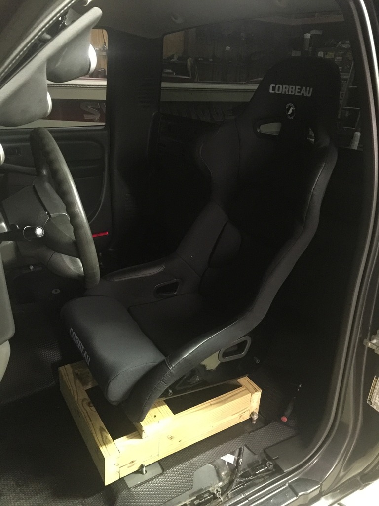

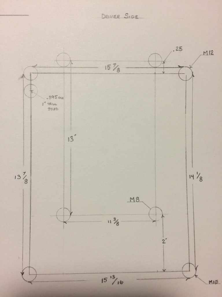

Little Update: Teamed up with Atomic to get some seat brackets fabbed up. Decided to throw some Corbeau FX1 seats in. After tons of measuring I think we've gotten on the right track and should have something soon. Can't wait to get this project up and running again!! Don't mind my amateur drafting lol
