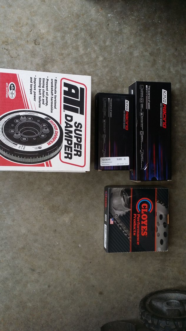

Most of the parts are in so assembly can begin. As is usually the case the direction for the motor has changed to prep it for boost down the line...hence the ATI Super Damper. Went with Diamond pistons as well since I got a smoking deal on them just after Wiseco acquired the company.
