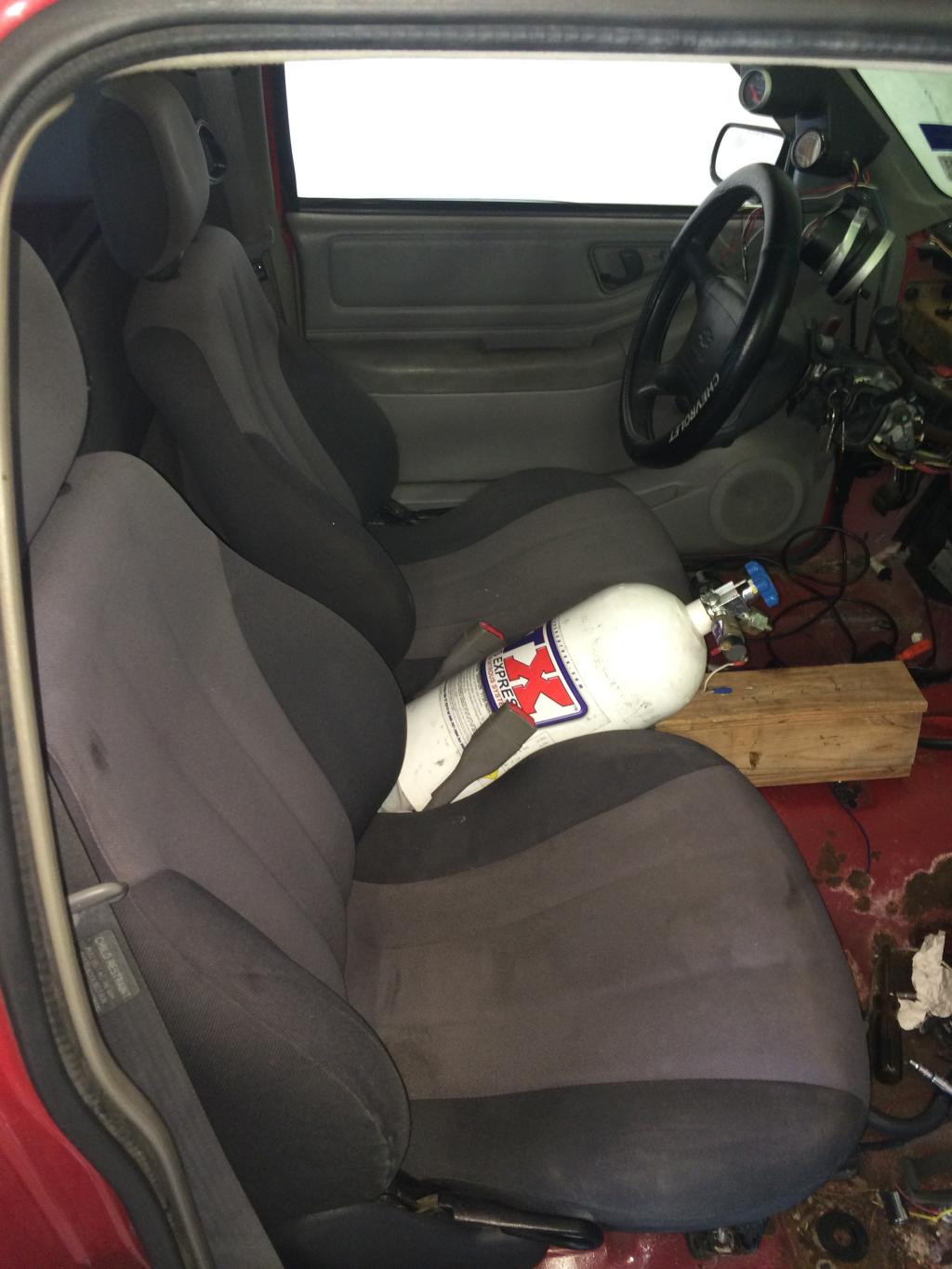

here is the idea of how it will look (minus the wood block lol). yes the dash and floor is going back in for a stock appearance. I think the 2 tone seat matches the factory door panels pretty good. seats need to be washed up.
and the right bedside body work is complete
it needs a new windshield, the dash is out and I need to pull the motor and trans...if I'm going to cage it, right now makes sense...I just don't want to. decisions decisions
