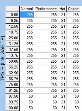

If the 80E TCC apply tables are left stock the converter will lock in 2nd when throttle is over 87% and speed is over 50 mph(60 mph in tow/haul mode).

Attached Thumbnails TVS 2300 + other Goodies in an '04 SSS-80e-2nd-gear-tcc-apply.jpg
