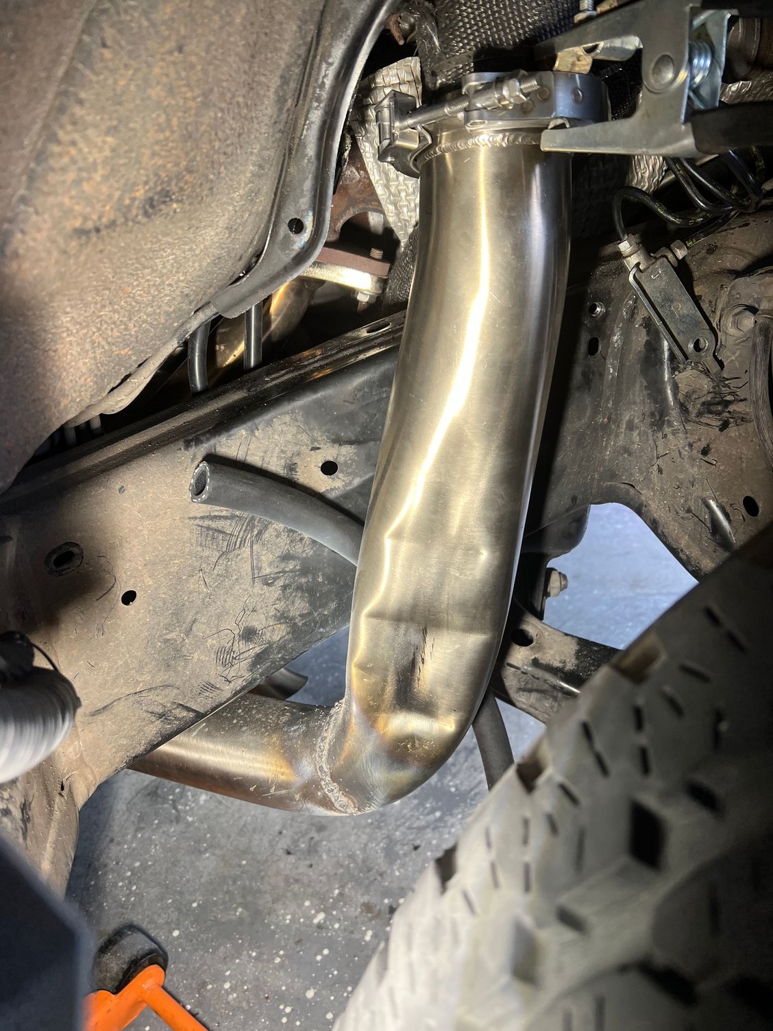

Awesome. Took the down pipe off to clearance it a bit for the tire and in doing so I straightened out the bend and now it doesn’t want to fit back in place.

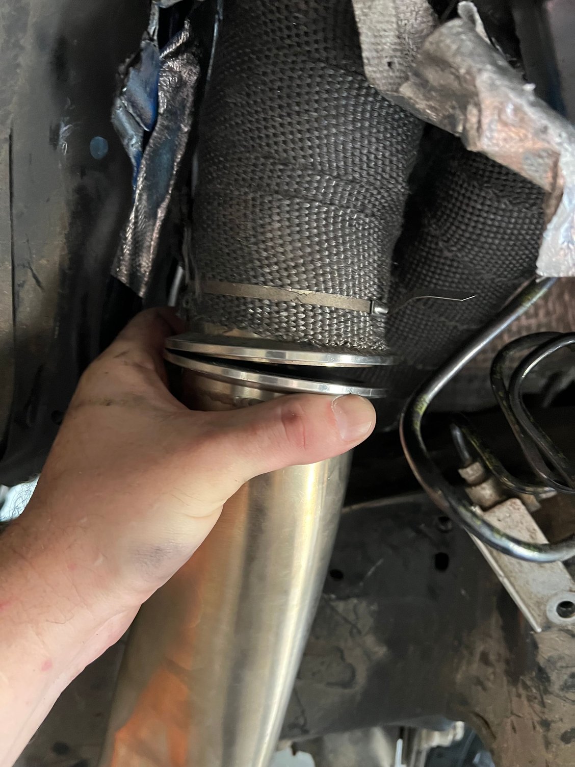

5hrs later it’s back in. V band doesn’t sit perfect but it’s at least enough to get connected and drive while I get a new one on the way.

Turbokits.com is a fantastic company to work with. They called me this morning and are shipping me their downpipe from their test truck to get my truck back on the road. Even offered to overnight it. I was fully prepared to have to buy a new pipe and pay expediting fees or something but all it’s costing me is shipping. Can’t thank them enough for this.

OOF! That's rough. Glad manufacturer is taking care of it. Curious if the prototype downpipe will be any different. Are your tires oversized from OEM? Looks like you have aftermarket wheels so that could also be a factor.
