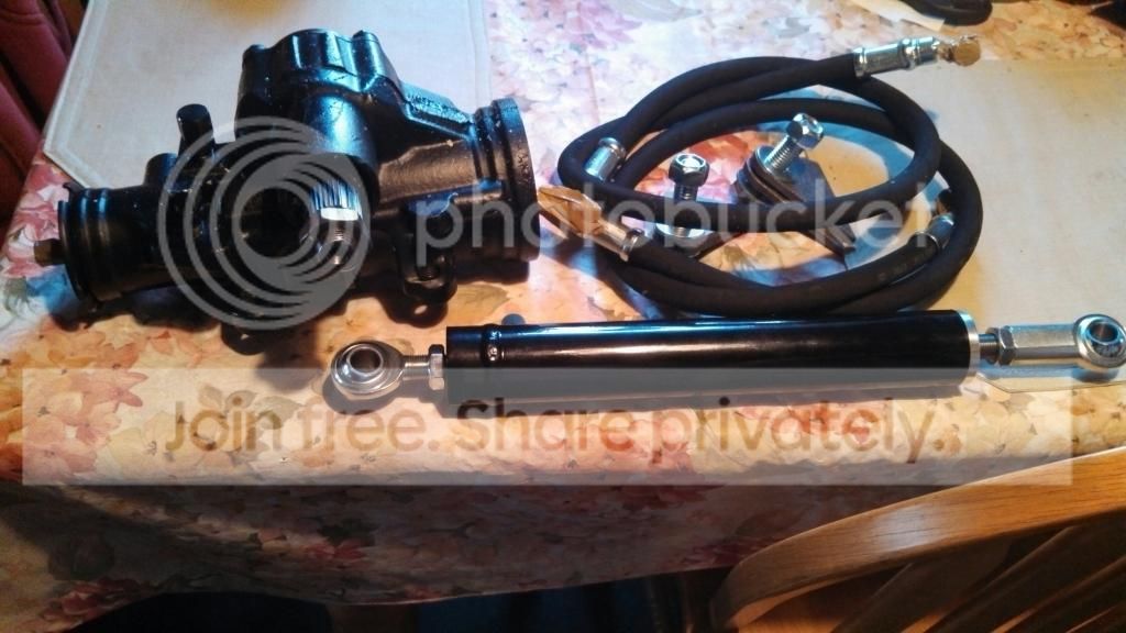

I wanna see that steering setup.
And yeah not many lifted trucks on here with big tires, I used to be one of them.
GREENSIERRA is the largest truck on the forum with something like a 7 inch suspension lift and a body lift. I'm sure he will chime in on this thread sometime.
The kit is from west texas offroad, redneck ram. Where you send your steering box, they port/tap and sell you the rest of the kit. The steering box is ported and tapped, mine was actually a redhead steering box. The 2 hoses connect one end to the box and the other to the cylinder. One hose is for left and one is for right. The pump you pull the valve out of the back where the hose screws in and drill the piston hole a little larger and stretch the spring. That way now it has more volume. If you look at the tierod mount its adjustable, that way it can be aligned and positioned where it needs to be. I have to do pics 2 ways tho, one of the kit with photobucket and the other 2 from my phone.
As far as the amount of lift the rear had 5 inch springs and a 2 inch shackle flip. So it sits right at 7 inches back there, these trucks sit lower in the front stock so to be leveled it has 8-9 up front.
