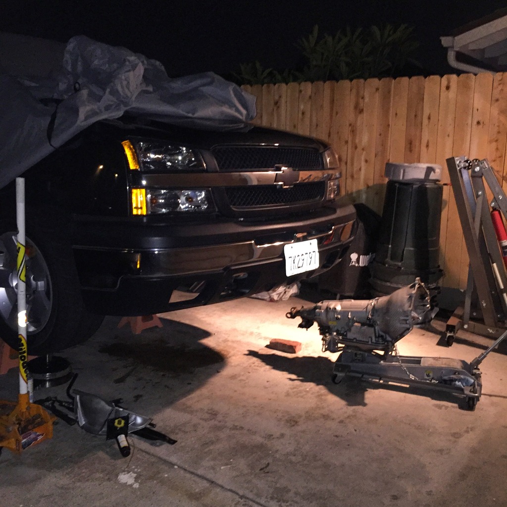

Dropping the trans out earlier in the week:

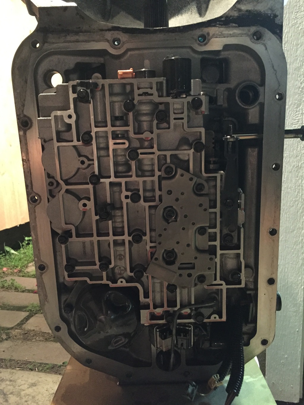

Finished installing the trans this morning and got it back down on the ground ready for a test drive when I realized I had no reverse or 4th gear... After some scan tool and pressure gauge testing and a little internet research and I decided to swap valve bodies with the other 4L80e that I have. I am suspecting the Transgo separator plate or possibly one of the other pieces of the shift kit. Swapping it with a known good VB will just help determine the problem.

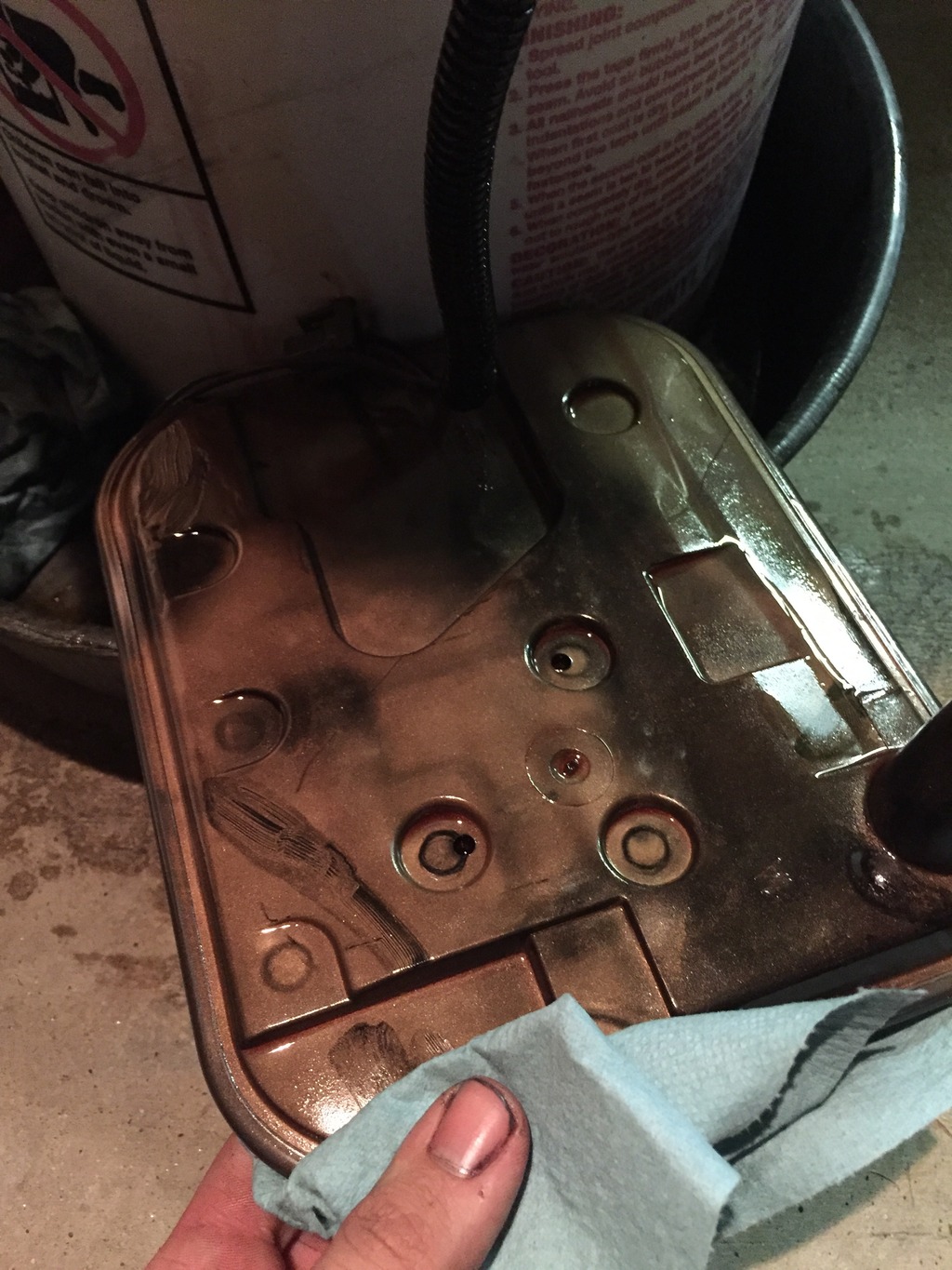

I pulled the pan and valve body off the other trans. You can definitely see the bushing material on the filter and gaskets. I'm going to clean it all out and get it ready to swap in.

I just finished swapping valve bodies. Got the VB from the known good trans along with it's factory separator plate and new gaskets in the truck. In the air I have 1st through 4th, lockup and reverse. But once I got the truck back on the ground it won't move in reverse.
