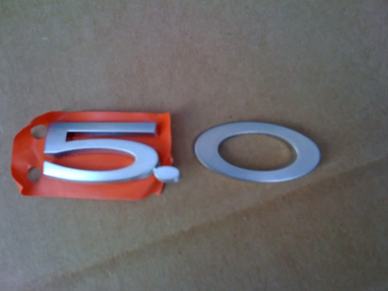

dug around my tool box and found this! will be going on my tailgate closest to 4.8 i can find
