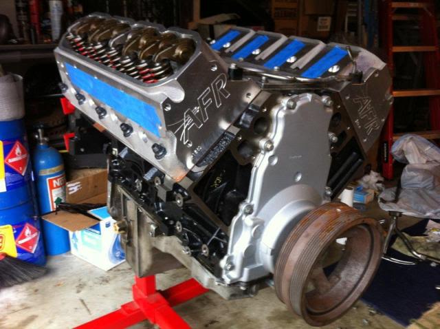

So I went back to collecting all my parts and started assembling my forged 6.0l:
New LQ9 bare block
Wiseco 4.005 -15cc forged pistons and rings
Lunati Pro Mod I-beam forged rods (used)
Stock crank (polished but no need for turning down .010")
AFR 225 66cc heads
ARP head and Main stud kits
Pat G custom turbo cam: .59x"/59x", 218/222 115+1
True Roller double timing chain
LS9 MLS head gaskets
Melling hi volume/standard presure oil pump

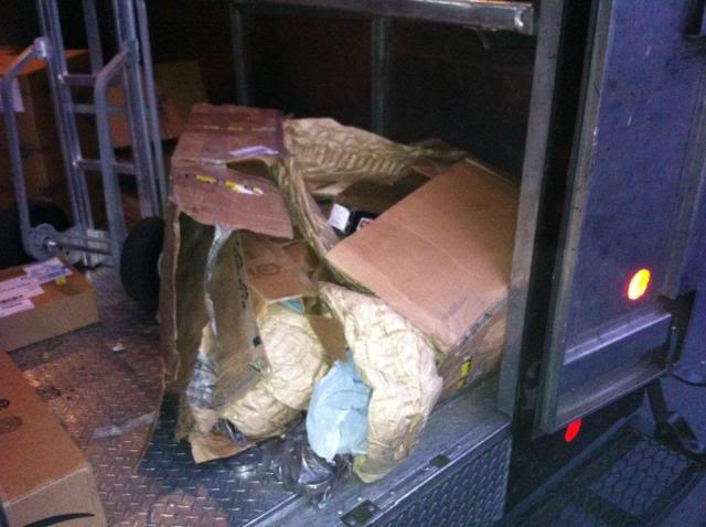

Alex and I go back 'n' forth for a few weeks and finally settle on a price. Deal is made, details worked out, funds are transferred and it's shipped from AK back down to Nor Cal. About a week later, The big brown truck pulls up and I get a knock at my door. I tell the UPS man to bring both boxes around to the driveway and he says I better come out to his truck...
The turbos and headers look fine so I tell the driver I'll take the delivery but he will have to note the damage to the boxes. Alex sends me a detailed list of all the parts from the dozens of pictures he had taken. After a very careful inventory, not a single item is damaged or missing.

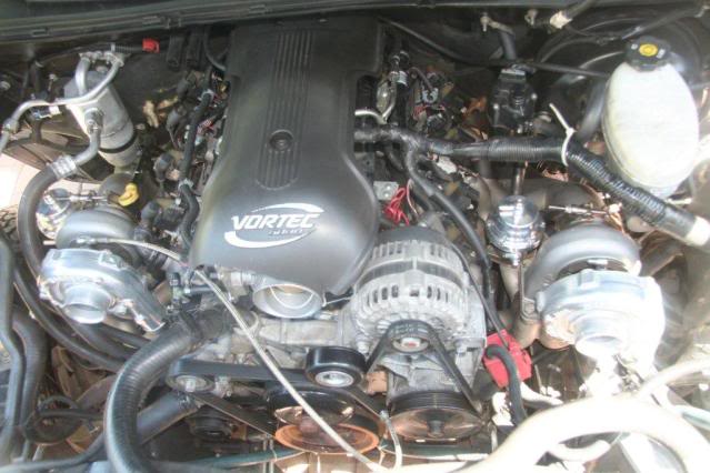

While I'm stripping everything off and returning my truck to "stock", I decide to drop off me headers, exhaust & compressor housings and down tubes at West Coast Powder Coating. The owner Kyle recommends their 2200* ceramic coating for the inside and outside with an external coating of their 1800* Titanium finish for the outside of the headers and down tubes. For the exhaust housing, we use a 2500* flat black and the compressor housing gets a thermal dissipating ceramic that will reduce the AIT's.
The truck passes the CA Smog Test and I'm ready to install the new kit.

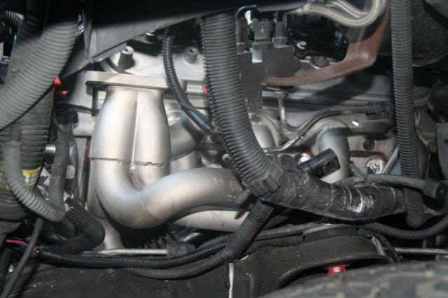

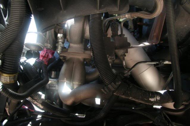

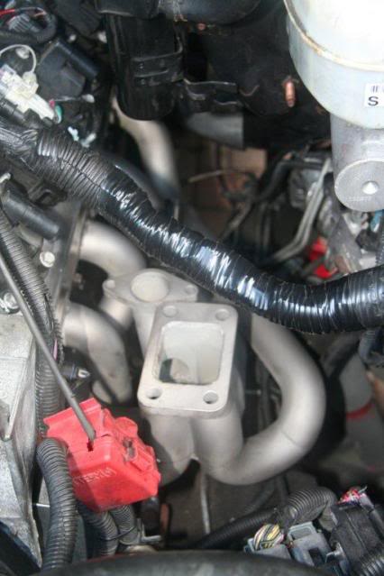

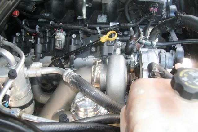

Then passenger header was a tight fit to say the least. After tweaking the AC
lines & fittings and the oil dipstick, I get it bolted down.

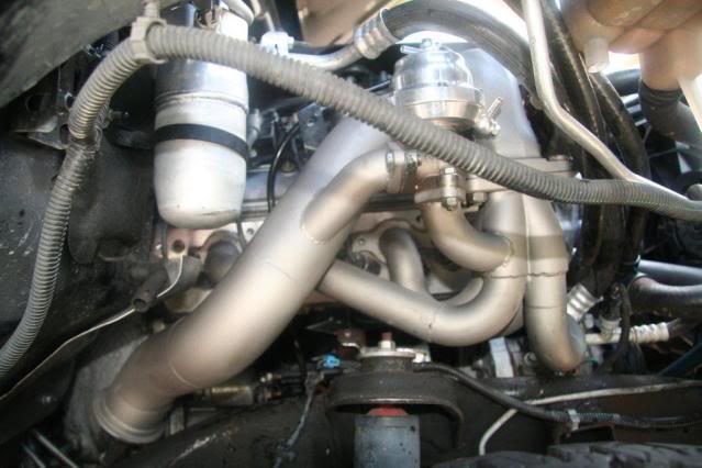

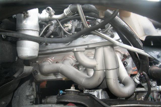

The driver's side was a little easier once I remove the steering mid-shaft. I had already made some tweaks with the brake lines from my Procharger days.

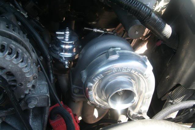

I reassembled the turbo housings onto the CHRA, added the -6AN oil and water fittings and bolted them, the Tial 38mm wastegates and the downtubes to the headers.
After plumbing the oil and water lines with braided SS -6AN lines and some-10AN SS for the oil return, it was time to start the cold side.

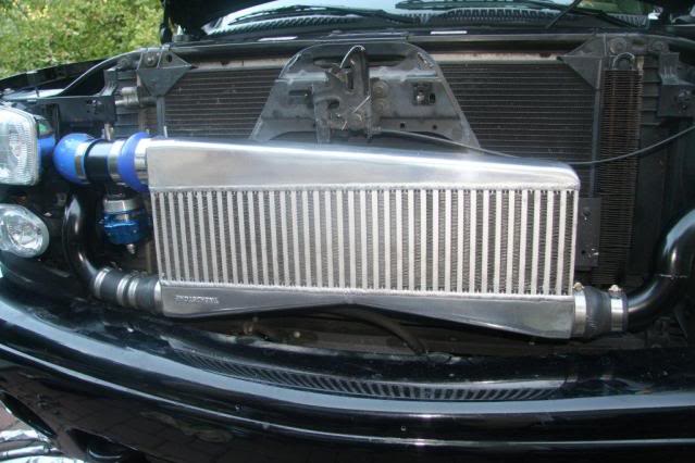

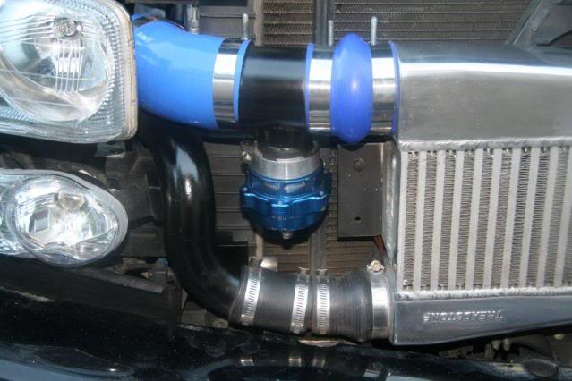

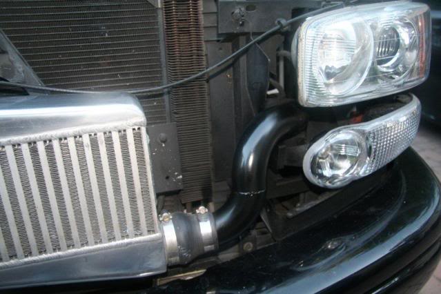

The Treadstone FMIC was the same model from my old kit so the initial pieces of the cold side were pretty straight forward.
I double check all the fittings, fir it up and drive it straight to my favorite muffler shop to get the new down pipes connected to my existing 3.0" mandrel bent exhaust system.
Next up is the fuel system. To be continued....
