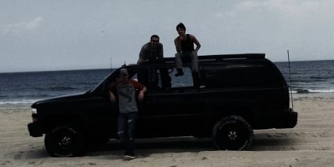

It's a 2003 Suburban that my Girlfriend calls "The School Bus." Bought off dad when he hit his midlife crisis and bought a Charger. And this is how it sits.
Was stock at this point.
Get larger tires and crank keys.
G80 with 3.73s explodes.
I overdo it and put 4.88s in the truck front and rear with a Trutrack in the 10 bolt.
Put some bullet hole wheels on it but more importantly I melt down the 4L60e on a beach.
Get everything and the kitchen sink with a 2,600 rpm converter
1.5 inch body lift and 33x12.5 muds.
Bend up a new track bar to clear the new diff cover.
Fun stuff. 226/226 duration, 0.598/0.598 lift, 111 LSA Cam. Also a Trailblazer SS intake with LS2 injectors and the 87 mm throttle body.
Annnnd the converter blows
So as of now Circle D 3,200 on the way.
