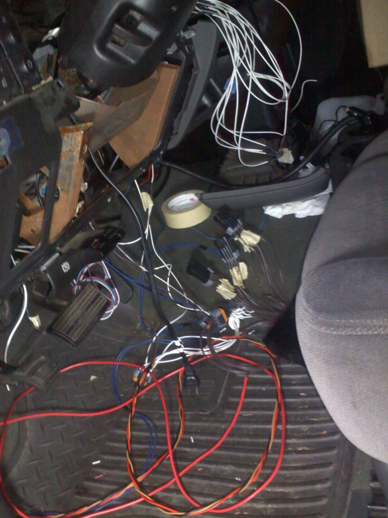

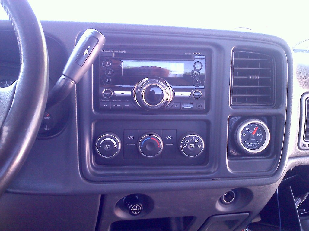

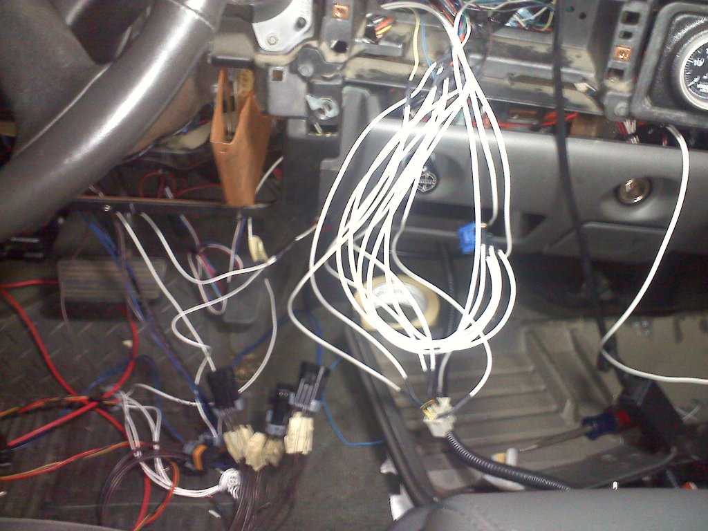

So after the 180 degree IATs at the track and 105 ambient temp while waiting in staging...I decided I had enough motivation to continue/finish my wiring project. With the E38 swap I found out that I couldn't run the stock HVAC unit because the ECM needs to communicate with it over a low-speed data line. So that necessitated buying a GMT900 HVAC unit and a BCM for the interface. Had I seen some sort of systems diagram for the new trucks and known ahead of time that it was going to take so much work and so many add-on parts to make the E38 swap work as it should, I probably wouldn't have even bothered in the first place. While I was pulling wires through the firewall for AC stuff, I ran wiring for the meth injection, new stereo deck/amplifier and provided the proper wakeup signal for the FPCM so I can get that thing online as well.

I think it turned out looking pretty nice. Seeing a decent finished project makes slaving for hours over a hot soldering iron a little more bearable

That's tight how you have nnbs ac controls in there! Thats definatly a one off set up! Nice job jake

Your head unit looks like it should startup and say " good morning, Dave"
