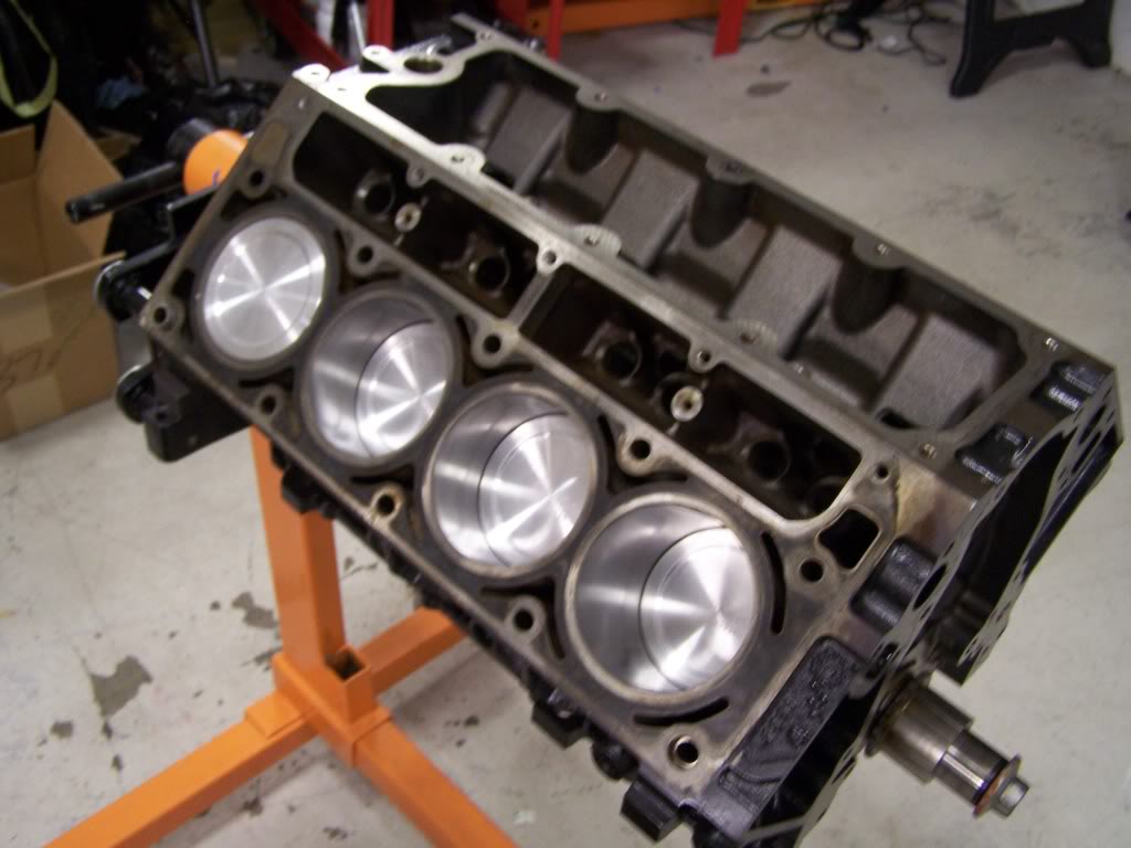

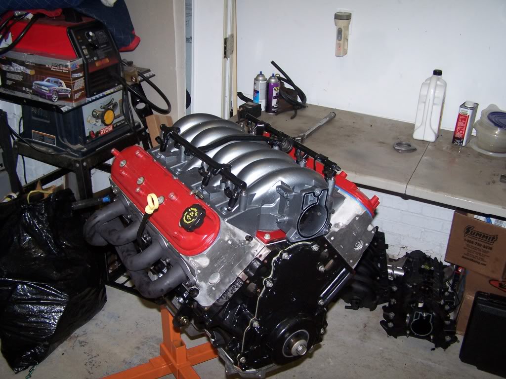

I've been on and off here, I've been posting most of my build on S10 Fourm in the LSX discussion but I throw in some pictures here.
Here the specs on the engine...
Started off as a salvaged 2002 5.3 from a Suburban.
-ARP bottom end
-Clevite bearings
-Speed Pro Pistons
-Sealed Power rings
-Ported and Polished 862 heads milled .015 with 3 angle valvejob
-ARP head bolts
-Trickflow .585/.585 lift, 228/230 duration 112lsa
-Trickflow double roller timing chain
-LS6 high volume oil pump
-Comp Cams beehive springs
-LS7 lifters
-Harland Sharp Rocker Arms
-Trickflow pushrods
-LS6 Intake
-Sanderson 1 1/2 Shorty headers
-H3 Alpha oil pan
-10.5:1 compression ratio

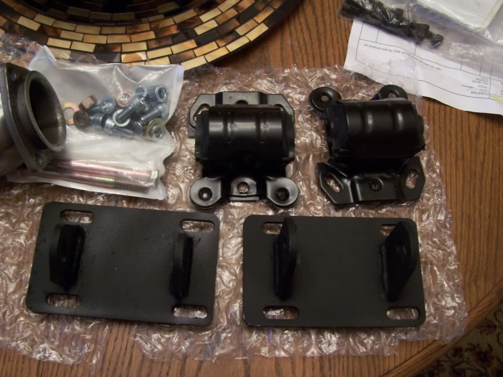

S10 Conversion mounts from CPW

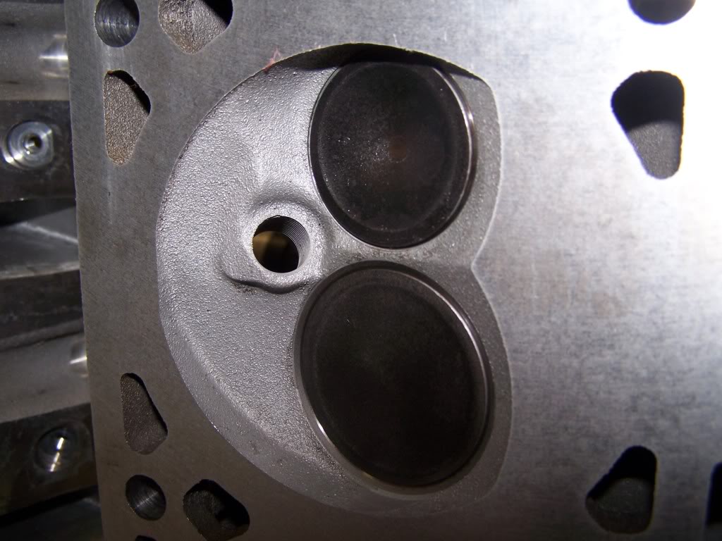

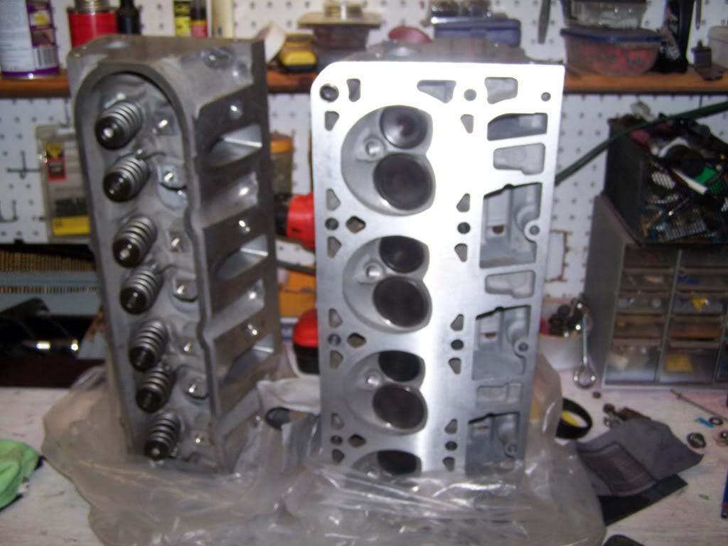

862 heads, milled .015

Currently broke now lol, but once the funds are back I'll be buying a 4L60E or 700R4 and rebuilding that to mate to the 5.3.
oh and most importantly here is what its all going in, 2003 S10 Xtreme
