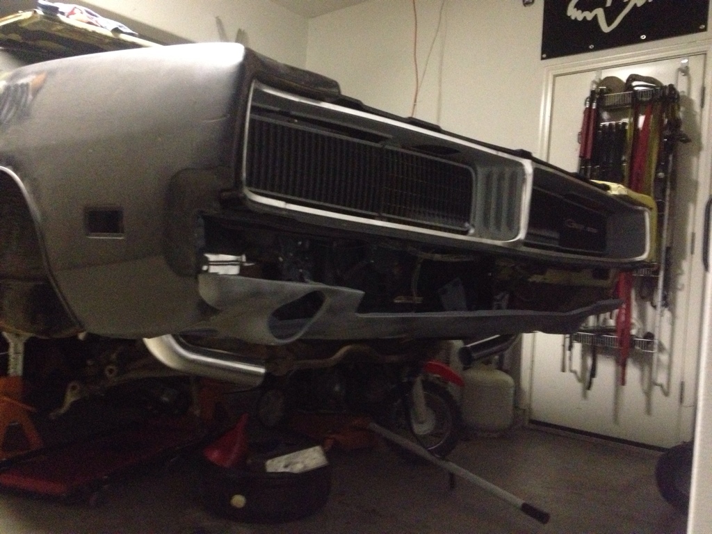

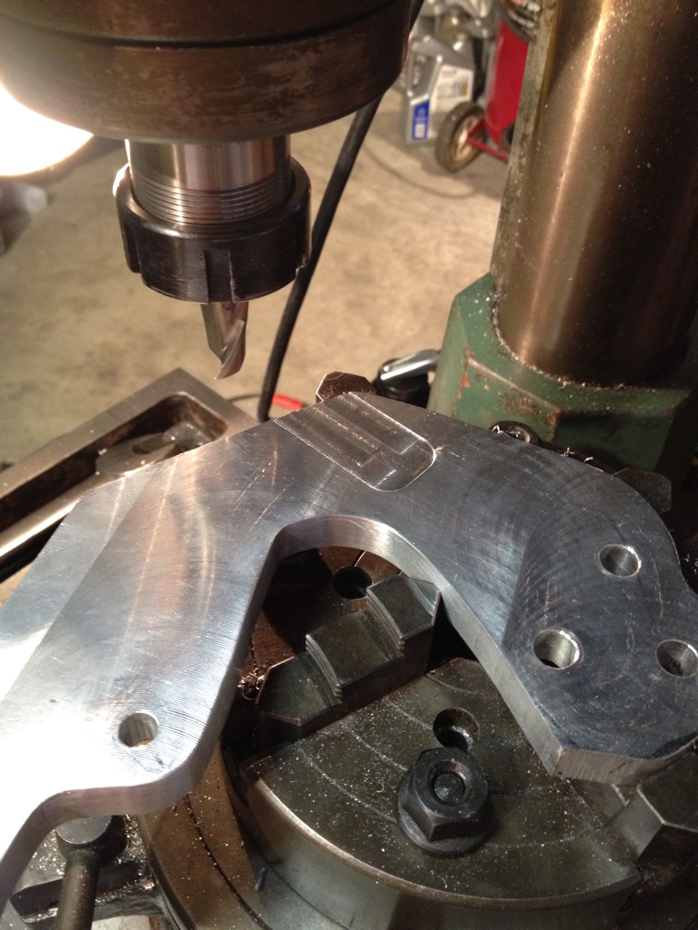

Thanks guys, I was able to get a little more done yesterday. I machined out the slot for the crank sensor, I welded up the exhaust and added brackets to mount to the trans. I also finished up welding the aluminum cold pipes going to the coolers. I need a 4" inch pipe before I can start on the cold pipe that goes from the coolers to the engine but I have a couple pipes in place (with tape). I also started assembling the front-end It's not close yet, I just need the grill in so I can figure out how I'm going to cram a condenser, engine oil cooler, Trans cooler, Power steering cooler, and two air to water coolers.....
Some more good news, I didn't take into account the bumper mounts when I mounted my Air to waters, now I have to modify the bumper mounts. Luckily it wont be too difficult....
