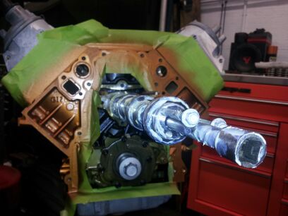

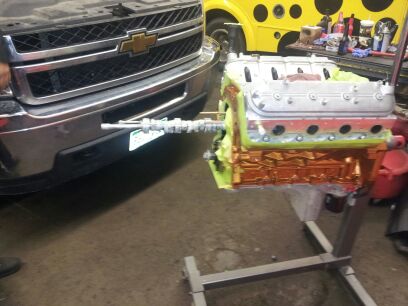

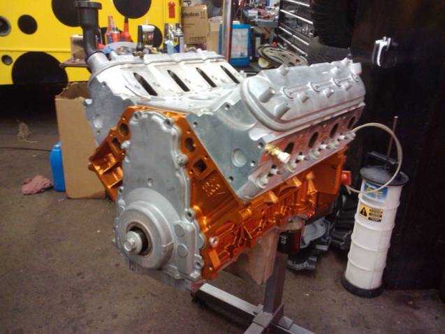

Got the engine all cleaned up and sprayed it VHT Burnt Copper, color looks killer in person, also slid the cam in and re-sealed the engine...

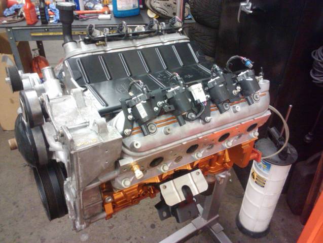

All sealed up and LS6 valley cover installed....

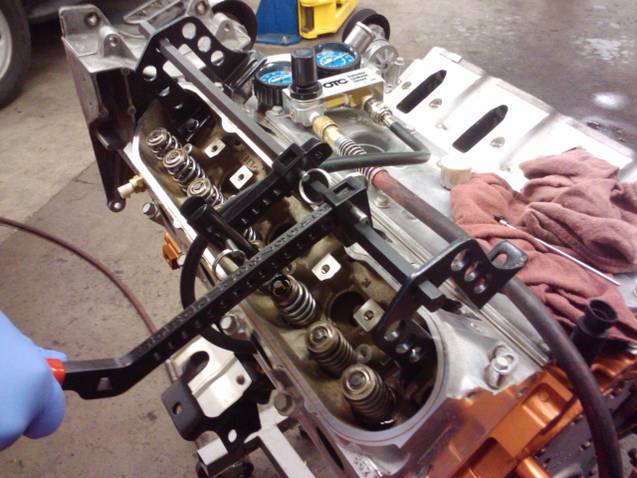

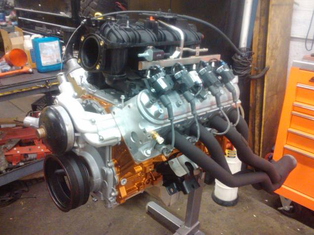

Got the PSI springs installed and mocked up the headers and TBSS intake...

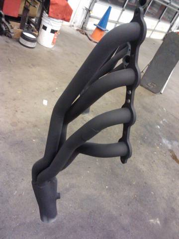

Sprayed the headers in VHT header paint, i know it woun't last but it looks better than they did lol...

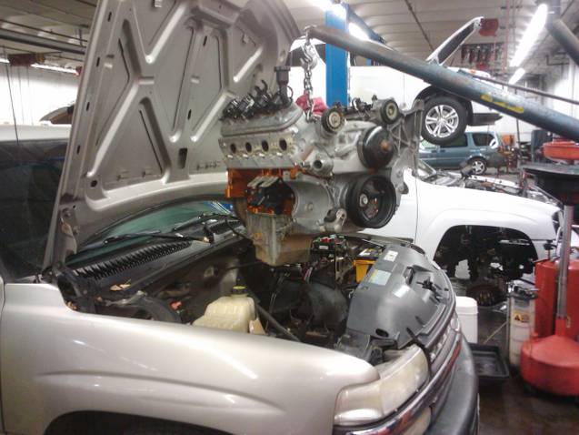

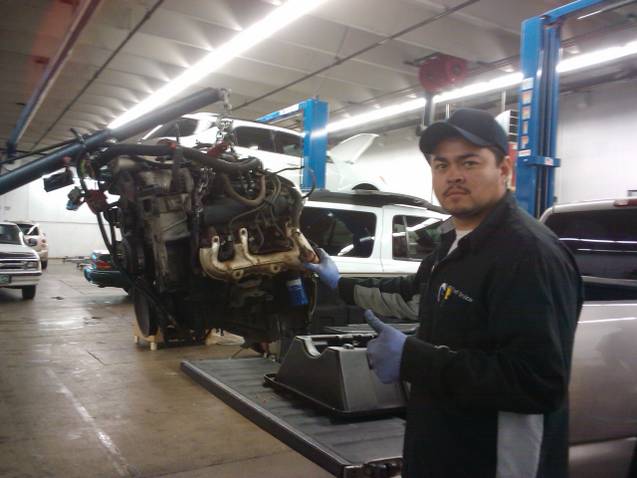

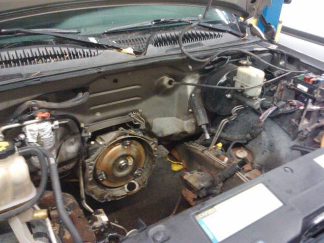

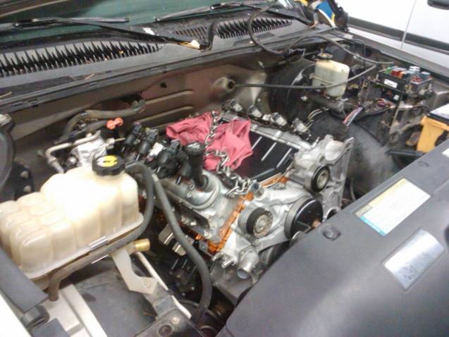

Got board on Black Friday and me and Ricky (in the pic) yanked the V6 out and dropped the 4.8 in...
Threw in a Yank thruster 3000 stall while i was there, we also did some painting on the frame (not pictured) and installed the v8 frame brackets....

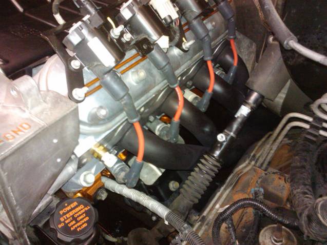

Got my freebie PS NNBS long tubes installed, they are not a direct fit if anyone wanted to know lol, had to dent in the cylinder #1 primary a little to clear the steering shaft, the o2 sensor placement is off also, got the bank one to fit but the bank 2 will have to be re-located...

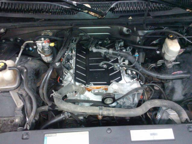

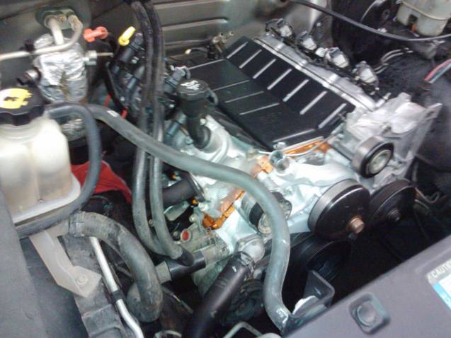

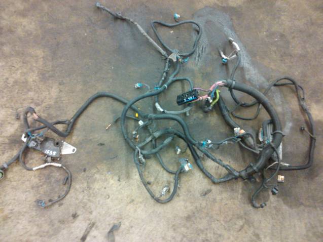

Got some grounds on the wiring harness repaired and installed the harness, also installed most of the hoses too..
