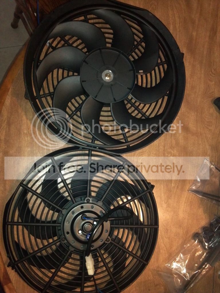

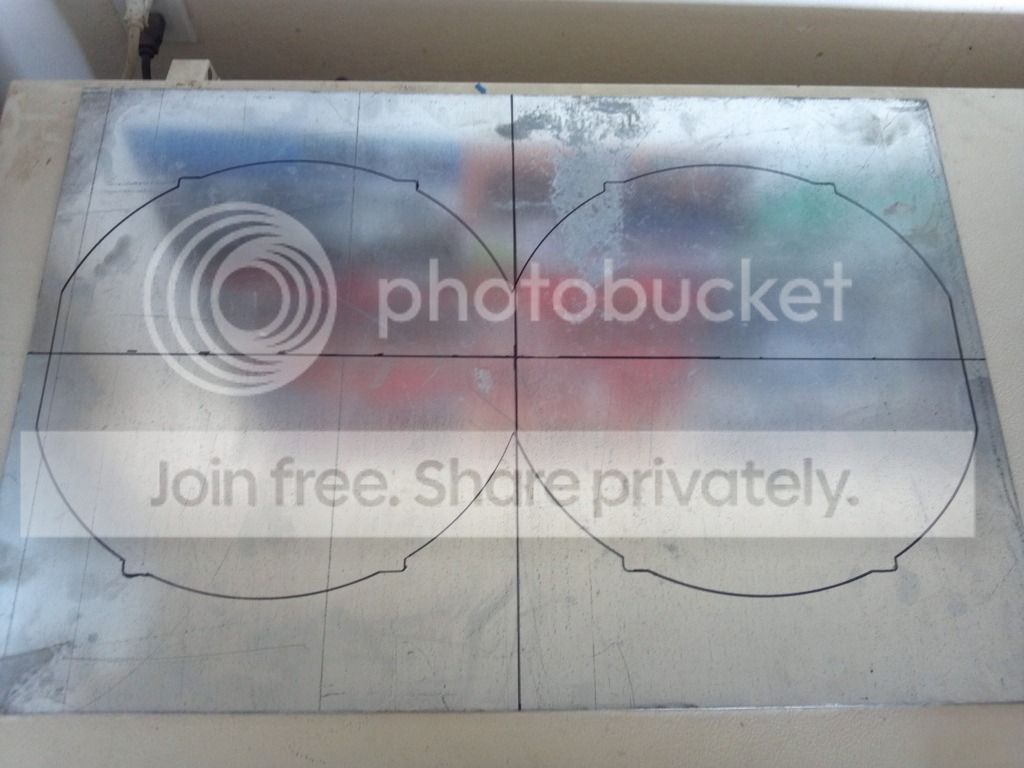

So some of you guys have been asking alot about the fans, well here ya go....
PARTS:
I bought 2 of these fans.....
14 Universal Pro Cool Electric Cooling Fan with Reversible Curved Blade | eBay
I was able to get a piece of galvanized metal for $20 im sure the prices will vary but shouldn't be too bad its about 1/16" thick.
Need wiring, fuses, silicone, and self tappers.
DIRECTIONS:
1. I Got the galvanized and had it cut to 29 3/4" X 21"
2. I had to use a grinder but i traced out the fans "od" and cut about a 1/4" inside of the lines to form the hole.
3.Once i got the holes cut out i sanded the galvanized then sprayed about 4-5 coats of high temp clear coat on it.
4.I then layed out the fans and use self tappers to mount them to the metal, once i floated them into place i applied high temp silicone around the whole fan "x2" to help secure and seal the fans.
5. Once the silicone dried I slipped the fans behind the radiator and used 5 self tappers to secure it to the radiator support.
6. We then hooked up the wiring, i had some issues finding the fuse to tap into so we just ran 2 toggle switches inside the cab. " made sure you add 2 fuses in the harness"
Pictures:
Fans when they came in

Fans layed out ready to trace
