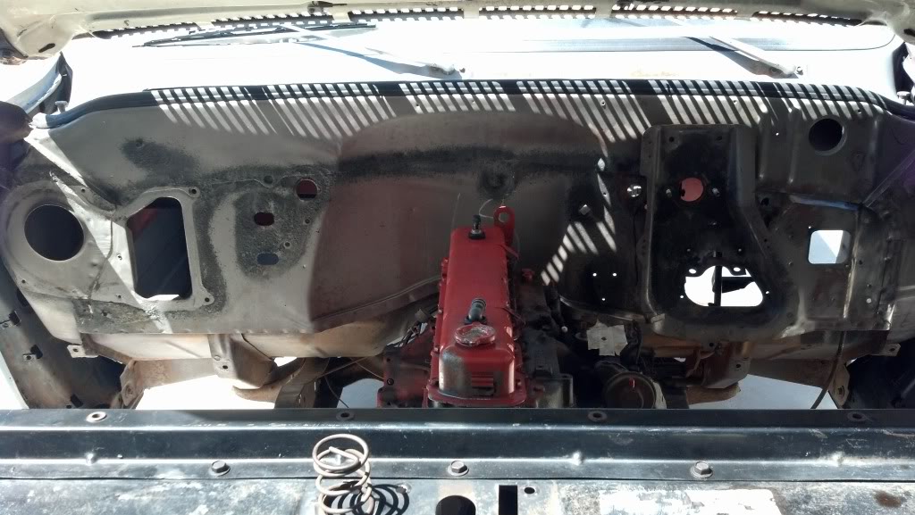

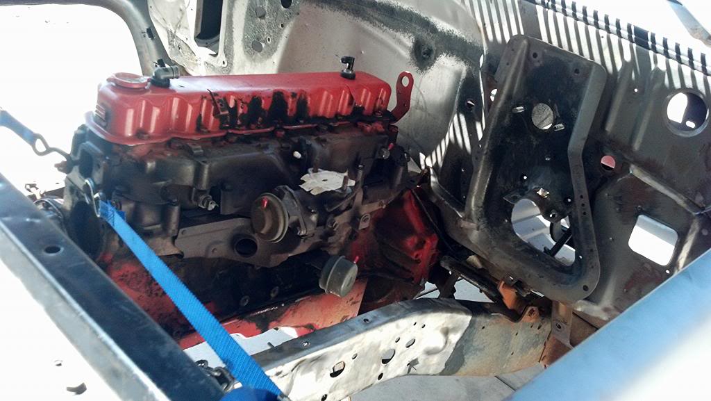

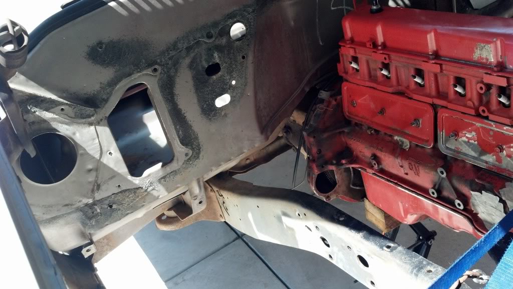

few updated pics:

What did you use to get the firewall so clean? I've been using de-greaser with a wire brush and scotchbrite with no end in sight on my 85 lol.

Mine wasn't too bad to start with, but, simple green, putty knife, wire wheel, and drill motor
