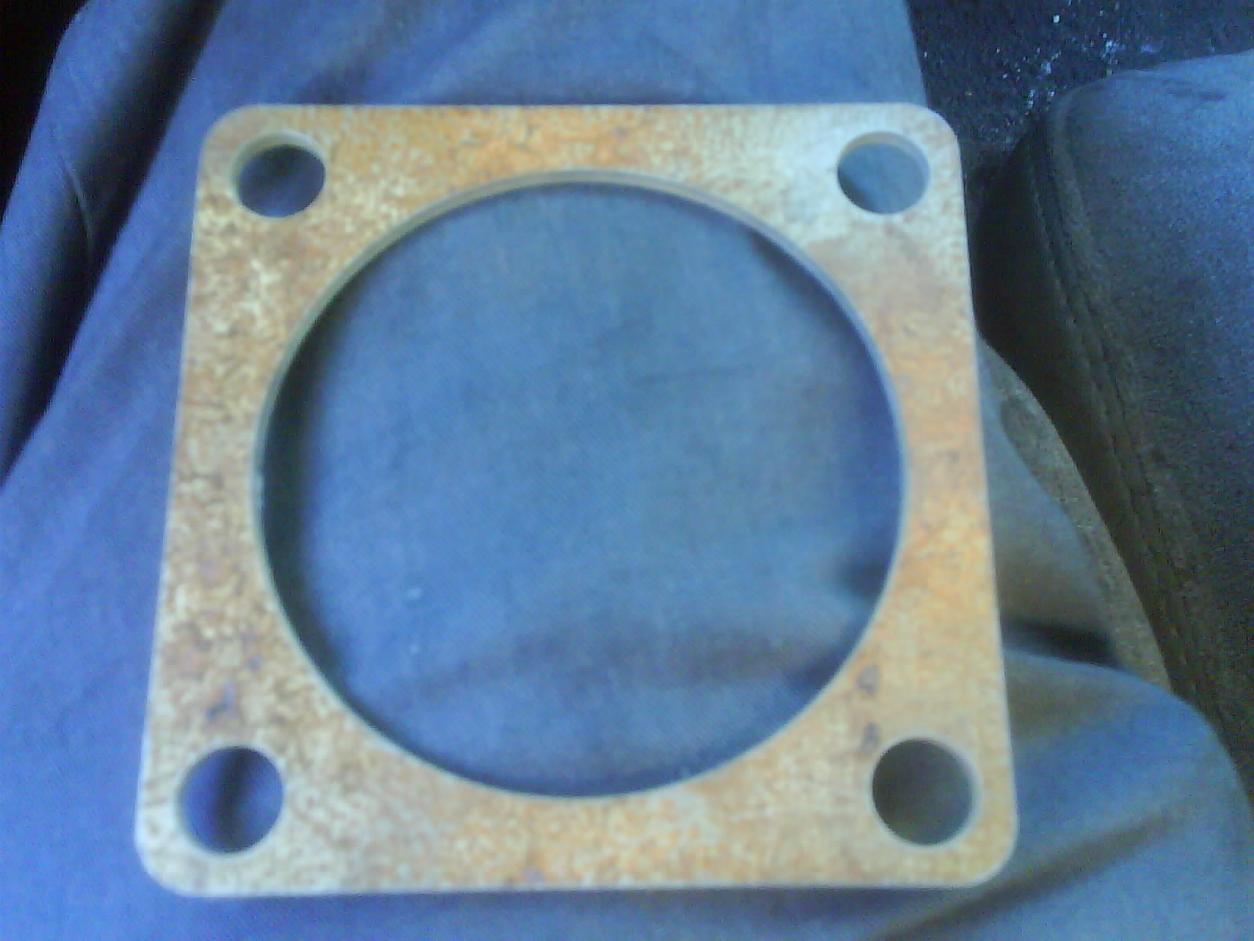

No pictures of the modded 14 bolt??? Was it out of a 4x4 with 6 lug???
sorry when i start going to town on a project i forget to take pics
14b was out of a 93 light duty 3/4 ton 4x4. It had 3:73's in it already which is the gear i wanted.
I cut the perches off and moved them over from 47 1/2" (88-98 center to center) to 49" (99-06 center to center). The bump stops and shock mounts are within a 1/8" of each other so I didn't move them. I have a friend that works at a machine shop made me spacers to shim out the caliper mounts/backing plates. they are rotated an 1/8 turn because the flange is [] on 88-98 and ,<> on a 99-06. The discs and calipers are dual piston from a yukon/tahoe. some people say regular truck rotors wont clear the outer diameter of the axle flange on an obs 14 bolt but my suv brakes did. Installed tru-trac, all new bearings and seals, TA performance diff girdle, and the new 1350 yoke I had on the 10 bolt (splines are the same on pinion).
Nice spacer!!! Atomic Needs some...
I will be makeing new flanges soon so they can be welded on and you can clock the brakes like the NBS style housing... see my template pictures...
The brakes rotors fit but not axles have a chamfer on them. Like atomics... He cracked the rotor.
I Have 4 of them. 2 OBS 2 NBS... Yes I have a Sickness!!!
Although I already know, I will be document the specific differencess with specific details and pictures soon.

yea its not that complicated. any gearhead can measure the difference in flange mounting height for the brakes, it was just easier at the time for me to do the spacers than the flanges. The axle flange to axle flange is the same width as 99-06 1o bolt, so it works out perfect. I probably have about $800 total in this axle with trutrac, bearings, cover, brakes, rotors, spacers, hardware, etc. people pay 2 g's for a vho or ss housing and its got drums and a gov bomb.
