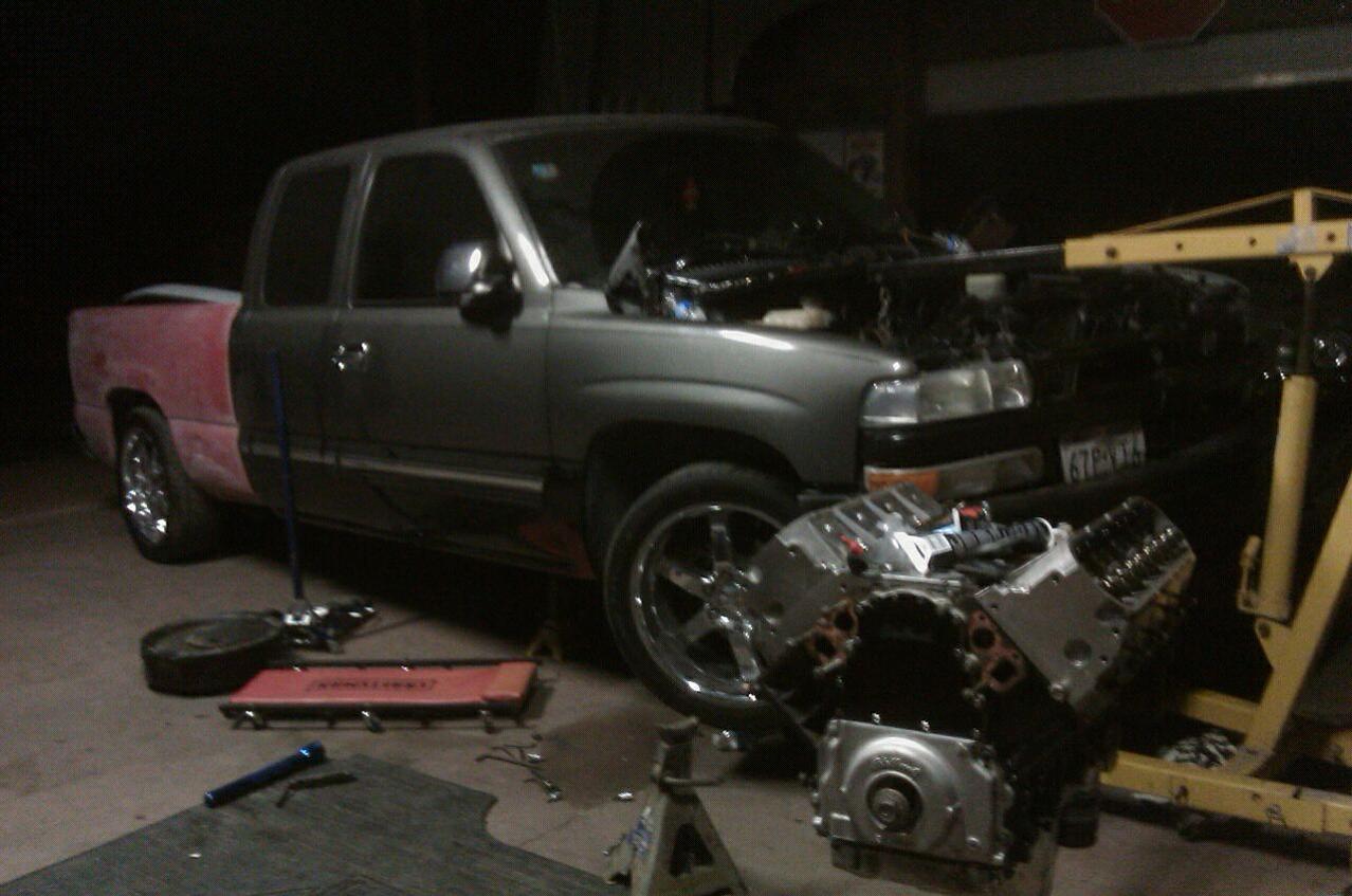

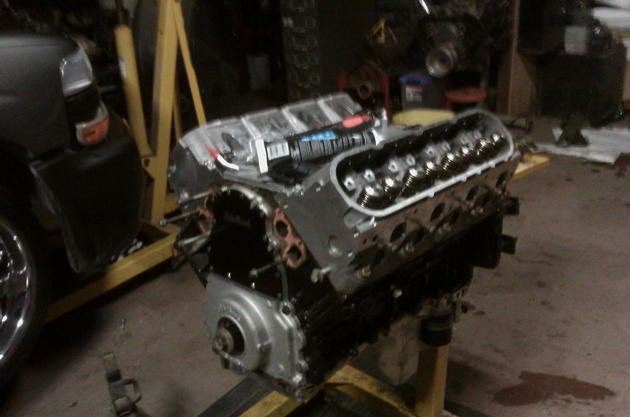

Ok so I haven't posted in a while. Anyays I pretty much put the engine together since I had just about everything. I put the sdpc stage 2 heads, along with my cam, timing set, cover, lifters, valley cover, etc. Only thing I have yet to install is my fast intake along with the throttle body. I'm undecided but was wanting to throw on some fuel rails and 36 lb. injectors.
About my tranny throwing the bb's earlier on the build I went ahead and replaced my stock convertor with a tbss convertor "FOR NOW". But then it came to mind that i was already spending so much money on the engine that i might as well just build the tranny to have that peace in mind that I went thru it to further investigate this weird bb problem. So I ordered a Monster transmission super sport kit to build my own tranny.
I haven't looked into a upgraded drive shaft, but will be doing so very soon. Any suggestions would be appreciated. Heres some current pics.

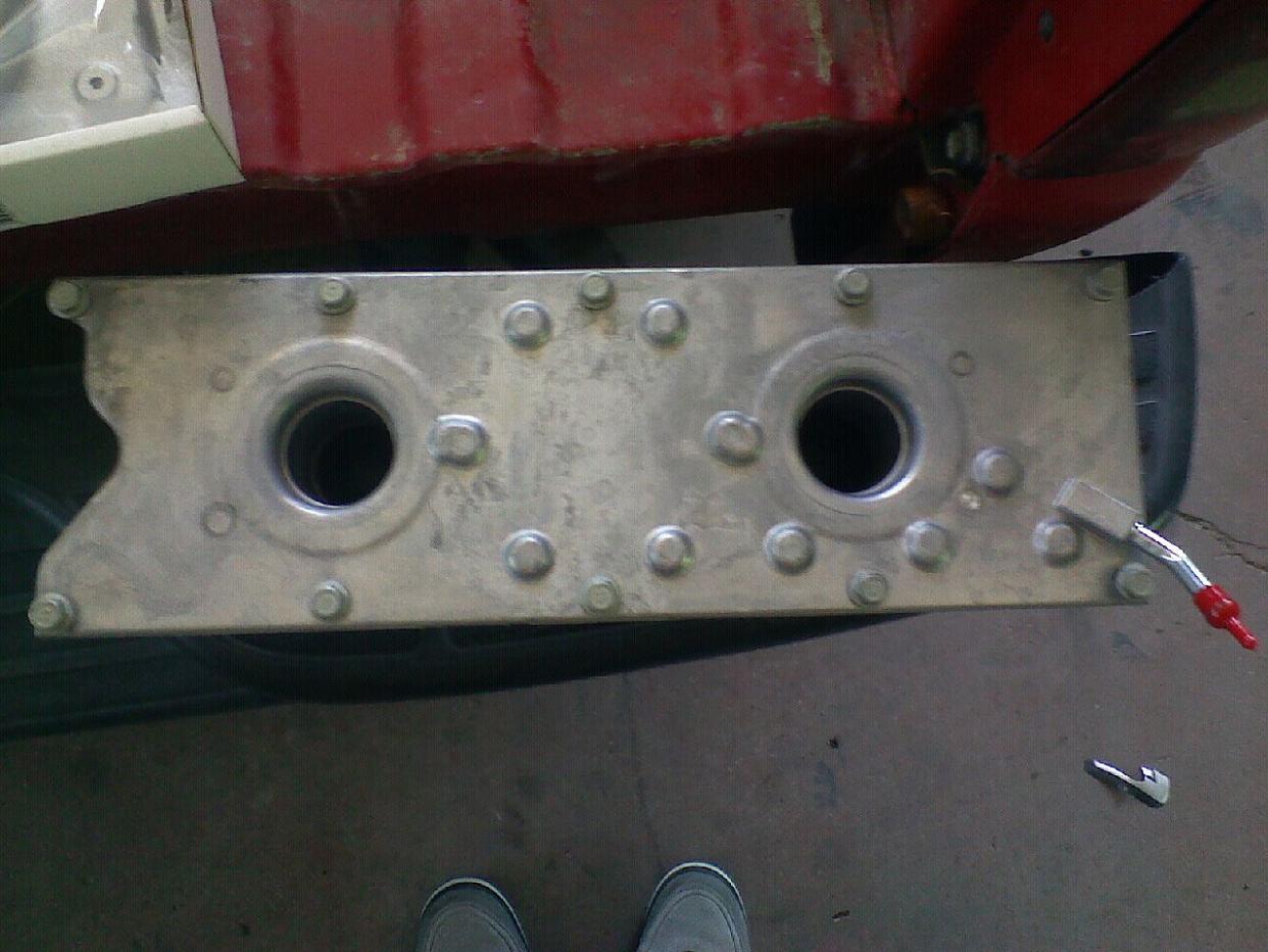

Ls6 valley cover.
2nd pic shows why i will be needing to replace my drive shaft soon.
