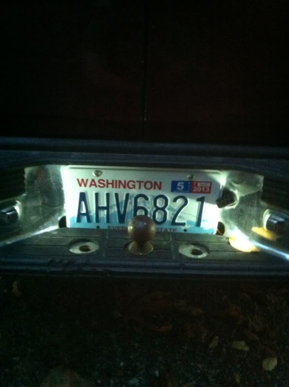

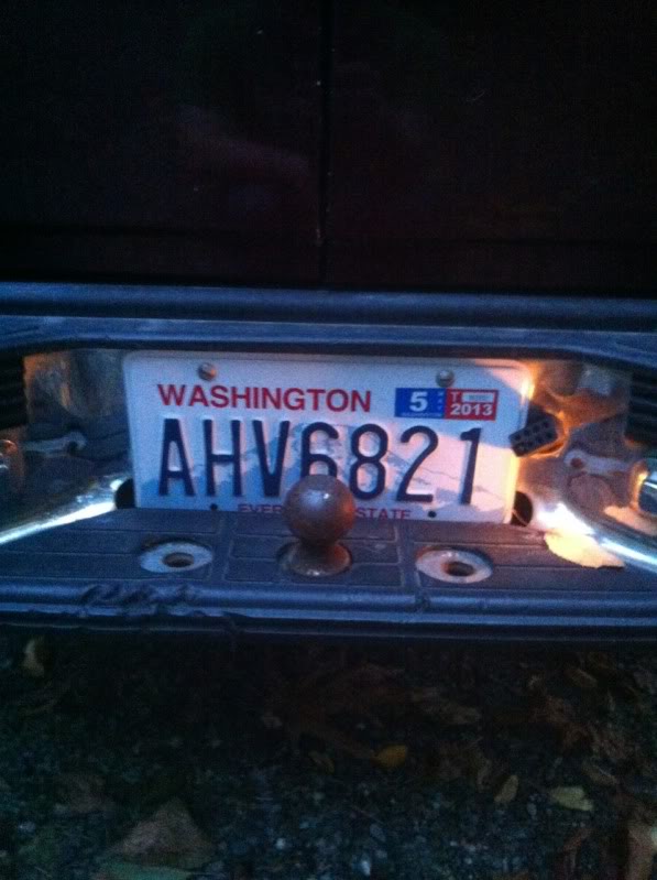

Another small update upgraded the tag lights to LEDs, since one of the bulbs went out.

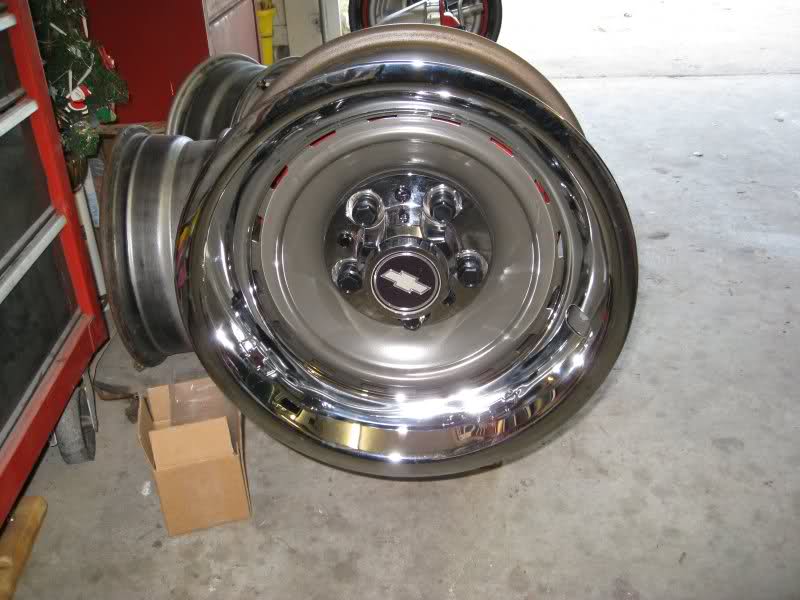

Okay another update. Got the drivers door hinge fixed as maNy of you guys with older trucks know that the bushings and pins have a tendency to wear out and cause the door to sag. Well that had been a problem for a while also started to mess up the latch. So got the bushings,pins,latch replaced and inner door handle that was glued as a temporary fix till properly replaced as well. The door closes like butter now. NO MORE SLAMMING!!!!! Gotta love it. I also have properly decided on what wheels I want. They are late '80s Chevy C10 wheels. Just to give it a little more classic more utilitarian look. Also easily allow for later widening of rear wheels for meatier tires.

Nice touch on the wheel choice. Is the LED licences lamp a plug in replacement???

Sure is. Cost the same as standard bulbs to boot.
Amazon.com: 2x T10 5-smd 5050 LED White Lights Bulbs for 194 168 W5w Interior,door, License Plate, Parking Lights(a Pair): Automotive Amazon.com: 2x T10 5-smd 5050 LED White Lights Bulbs for 194 168 W5w Interior,door, License Plate, Parking Lights(a Pair): Automotive

Good idea with the shoe dye. I will have to try that when the season decides to change to something a little less shitty. I am still unsure on the diff. I decided I want to stick with the 5x5 hubs so I can get the C10 wheels. So that may limit my choices of factory swap-able options. I know I either want a LSD or locker that I can control with a switch. Other than that I am positive I don't like the diff that is stock, always free wheeling a wheel and it is pretty unpredictable.
