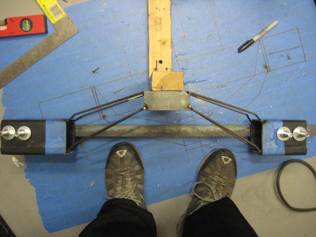

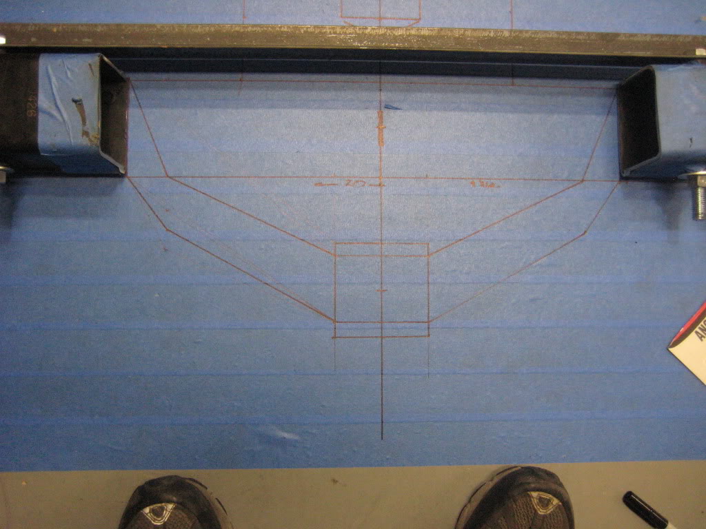

Here is the wire frame for my cross member for the 4l80... I could not do more because i when i picked up my hood, it was shattered... so everything is tacked and mocked up... Next i gotta start cutting some plate...
My poor hood...

The plan
My homemade jig
