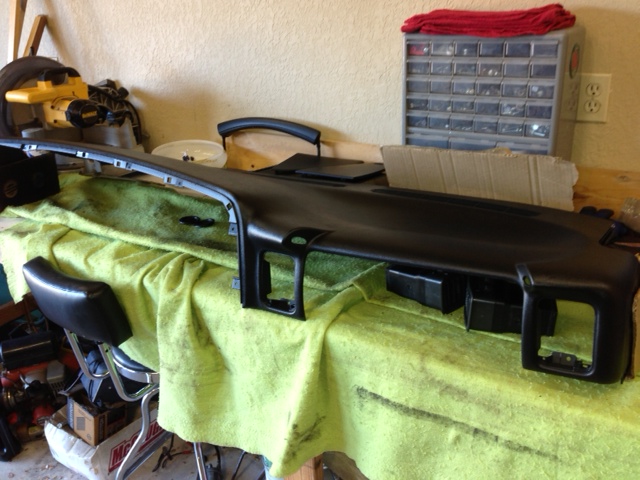

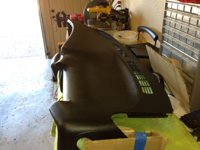

Dash was peeling. Powerwashed it to strip all the factory grey. Prepped and painted with SEM satin black. Interior will be '03 charcoal and black.

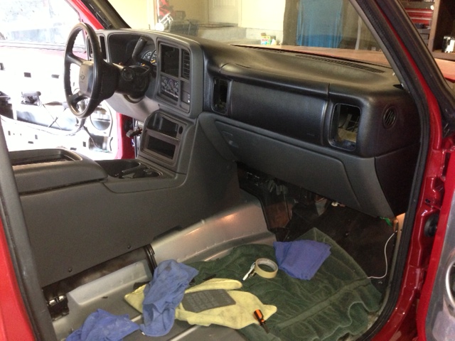

Mocked up '03 dash bezel and console. GM doesn't make anything easy. The HVAC panel needed to be lowered about 5/8". Found numerous threads on this mod. Also, I had to file on the bezel a little at a time to get it to fit the contour of the HVAC panel. Oh, and my $40 ebay leather wheel (it's in great shape). Came out great if I say so myself.

looks awesome!
I think the cleanest simplest interior is that dash with the full length console in a regular cab like that
How did the SEM satin turn out compared to a factory black finish? I need to paint my charcoal one black.
I wonder how the bottom part (thats still charcoal in your pics) would look in red, (thinking C5 Z06 interior) might be too much tho
Thanks for the compliment.
I've actually never seen a black factory interior. But, when I powerwashed the gray from the dash it was black, but it was too shiny for me. I tried the SEM Landau Black, but still it to was too shiny - why I opted for the satin. The shiny black just looked too much like plastic, even though it is plastic - but, you get the idea.
