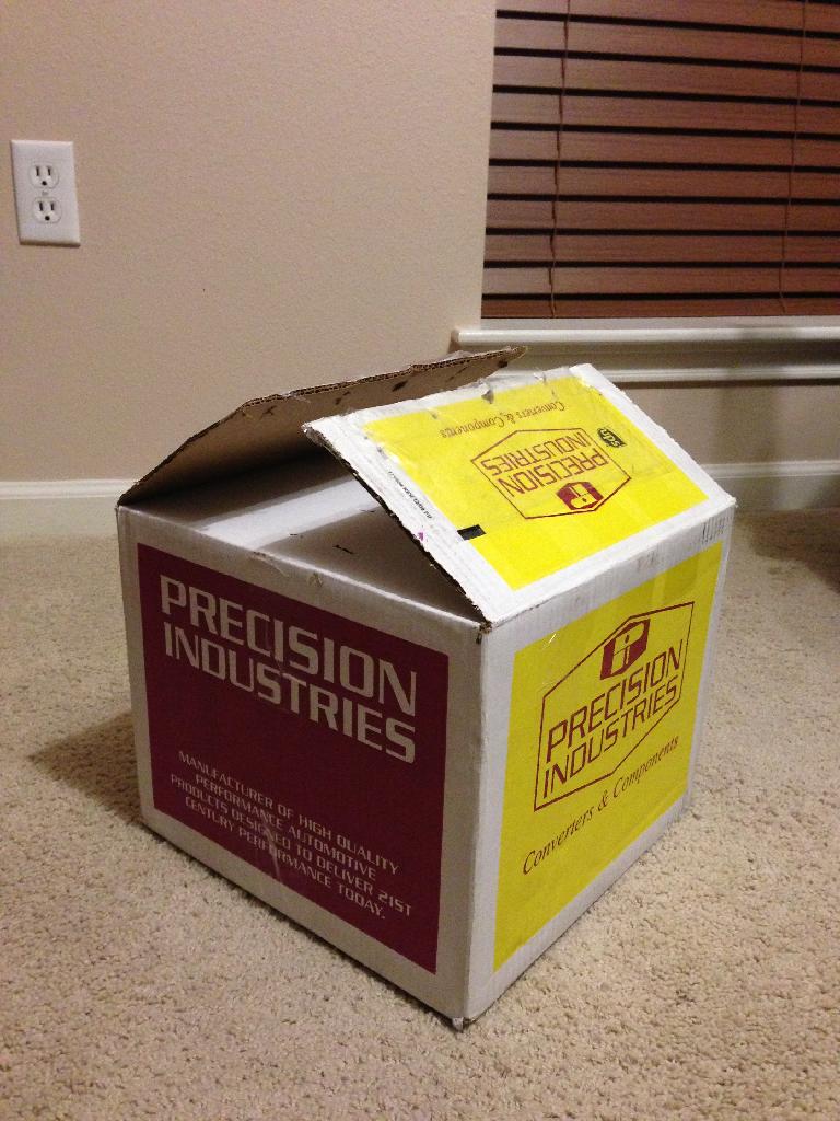

Built 4L60E with all the goodies and a PI Vigilante 4000 stall.
