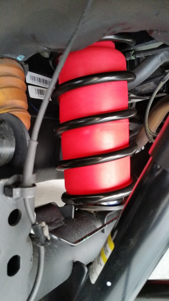

Bags installed holding 30psi

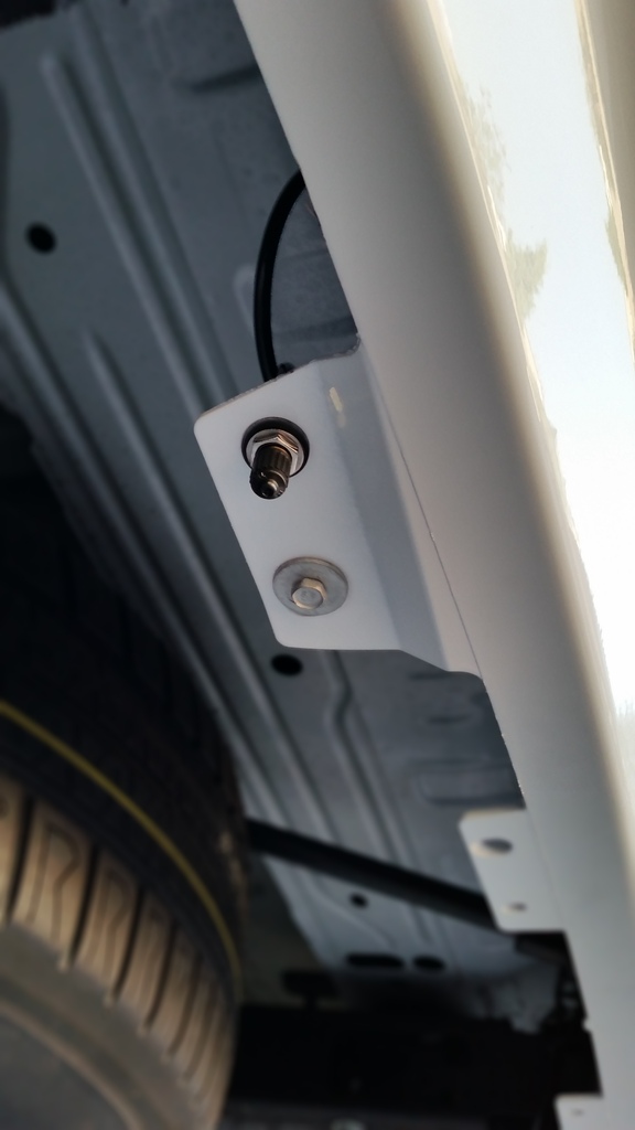

Mounting location for airbag fill:
That's slick.

thanks man, yeah it was an existing hole with a mirror tab on each side and with the bolt securing the other end of the tab to the chassis it's fairly sturdy; so I mounted the bags independently instead of using the typical T-Line approach. With the rubber washer under the ARP stainless washer in turned out pretty good I think. I'll add some loctite blue sometime today to ensure things stay together! Also, not seen in this pic, I have a "service" loop on each line in case I need to modify the location or make a repair.

very easy, but surprisingly "it is" a little cramped back there in Suburban rear suspension land so I took the rear wheels off which helped quite a bit IMO.
I folded the bags two ways and secured then with zip ties before I installed them in the coil springs so they were pretty damn flat and I also made the air hose connections to the bags before I installed them.....if that helps at all.
