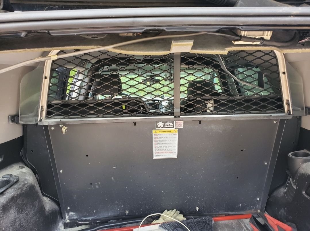

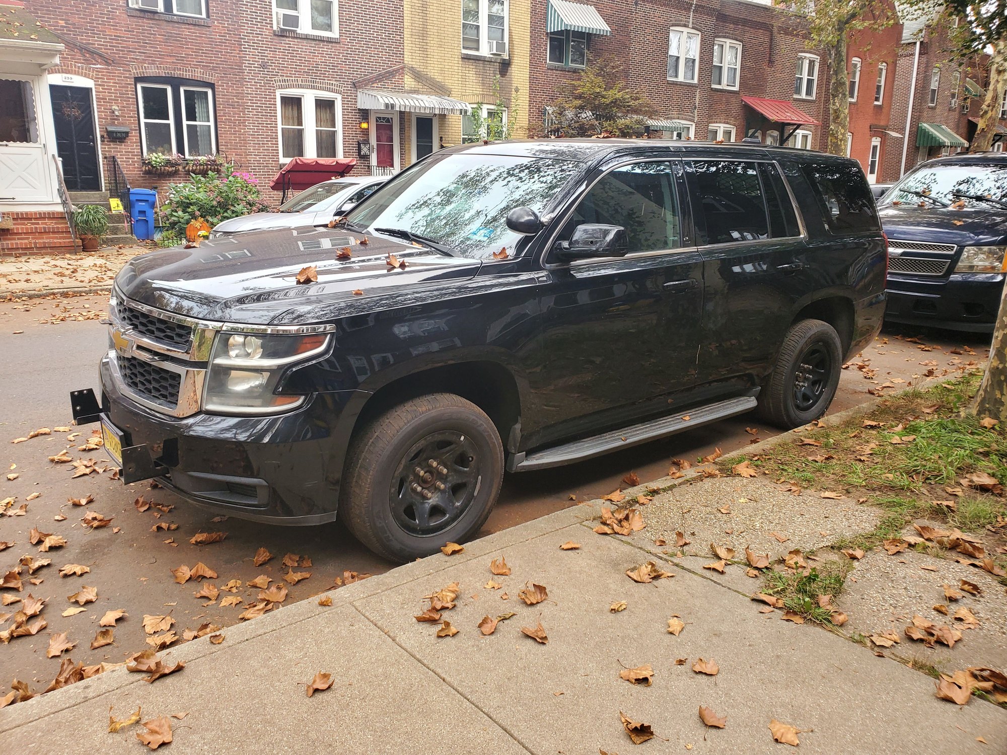

Picked up a inexpensive 15 ppv tahoe 4wd. Wasn't running and whoever was given the job to remove police lights did a hack job damaging stuff and leaving hot wires everywhere. So far removed metal center console, front half of cage and formed plastic rear seat and Mrs helped with all the lettering
